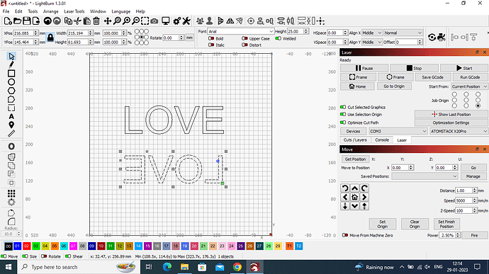

Hello,
Whenever i try to cut a text, it cuts in opposite direction.
I.e. i have to flip the side of my material to cut on the right side. It will cut opposite.
IS THIS NORMAL ??
No. It’s likely that you have your machine origin set incorrectly in Edit->Device Settings.
Atomstack X20 should be set to bottom-left. Review the origin setting and change to bottom-left it’s it’s not set that way currently. Based on your correction I assume you’re currently set to bottom-right.
Thanks Sir,
Job origin was bottom-right.
I hope you mean machine origin. Job origin is a different concept and is used in Laser window.
Yes Sir,
Thanks
