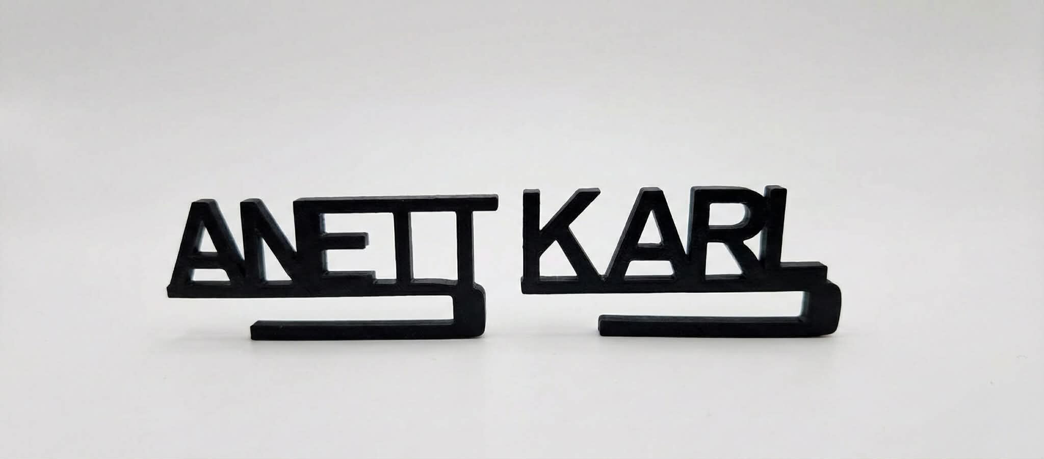

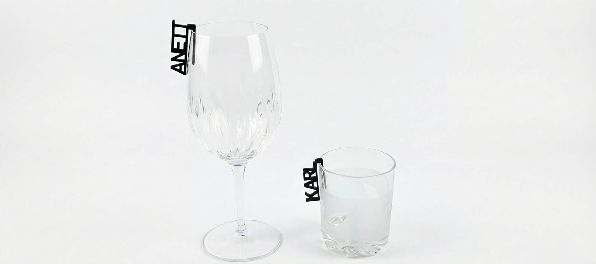

Hi! I haven’t worked with acrylic before, but my niece is getting married in a couple of months and wants me to make name tags for the glasses. I’m using a Algolaser Delta 22w machine and just finished some test cuts. After a few attempts, I managed to cut through 3mm XT black acrylic at 600 mm/min and 100% power. Do you have any tips on how to make this easier or any suggestions for better parameters? And maybe some more tips?
