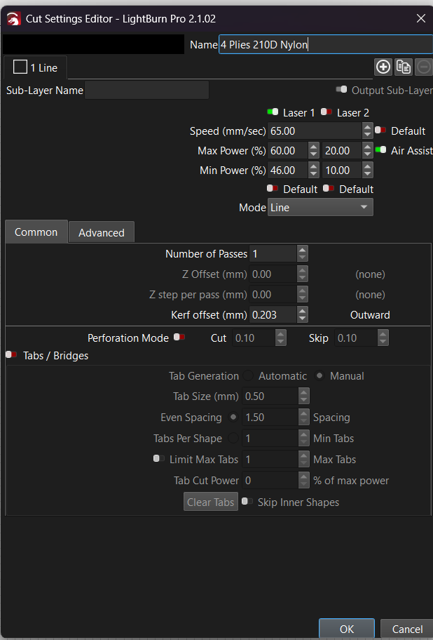

I have extensive experience cutting lightweight materials for ultralight backpacking gear. The stuff I cut works well - mostly EPX-600 (polyester), Dyneema, and 210D Nylon.
The nylon 210D I can cut in 4 or 5 plies, stacked layers. 130W CO2.
