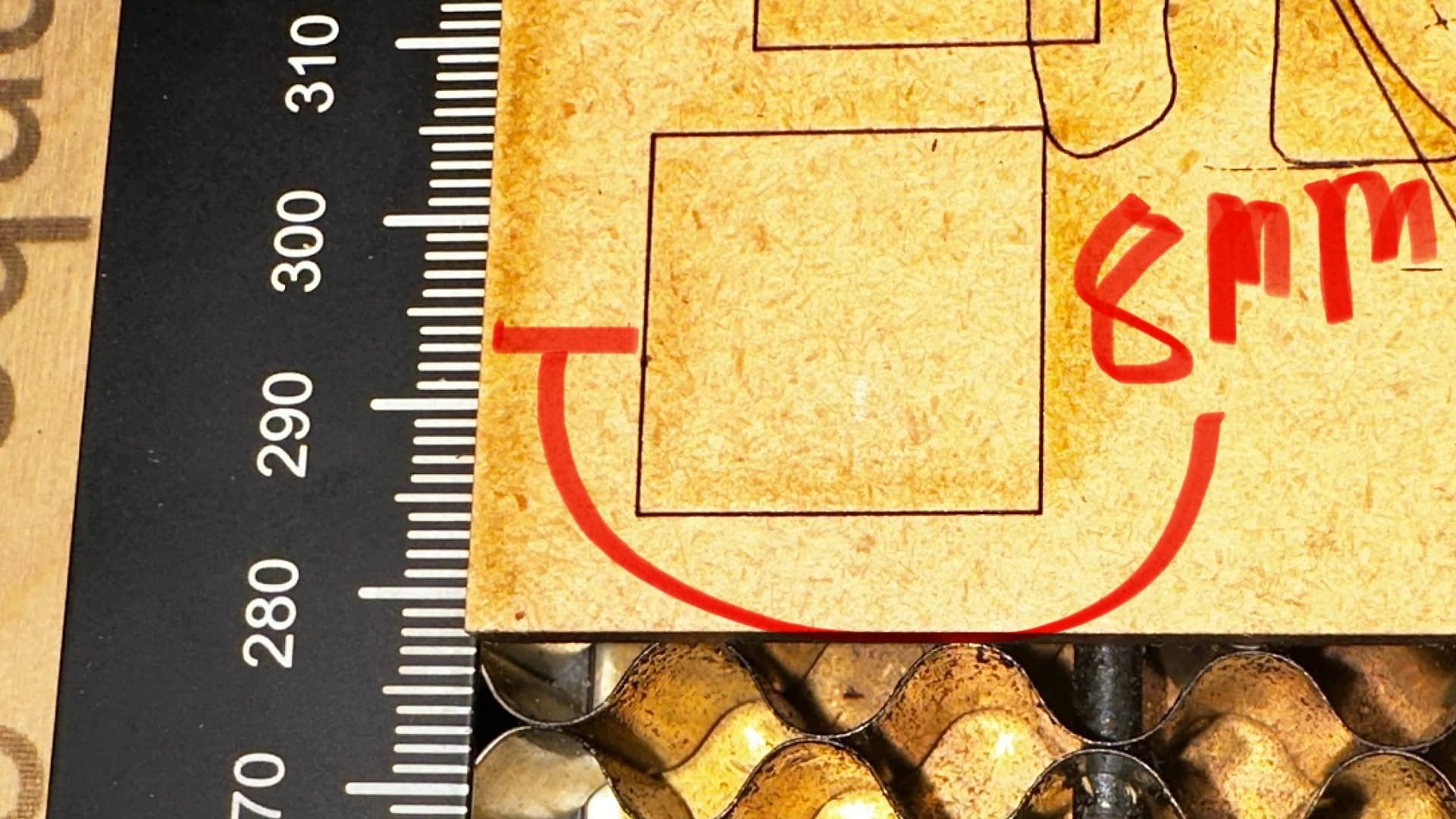

With Lightburn and an Xtool D1Pro I am trying to cut the same shape through from both sides of the wood but can’t get it to align. I’m using a squared piece of wood placed accurately in a jig to make the first partial cut but when I flip the workpiece and the image in lightburn the cut is about 8mm out and not cutting as shown on the screen. Am I doing something fundamentally wrong?

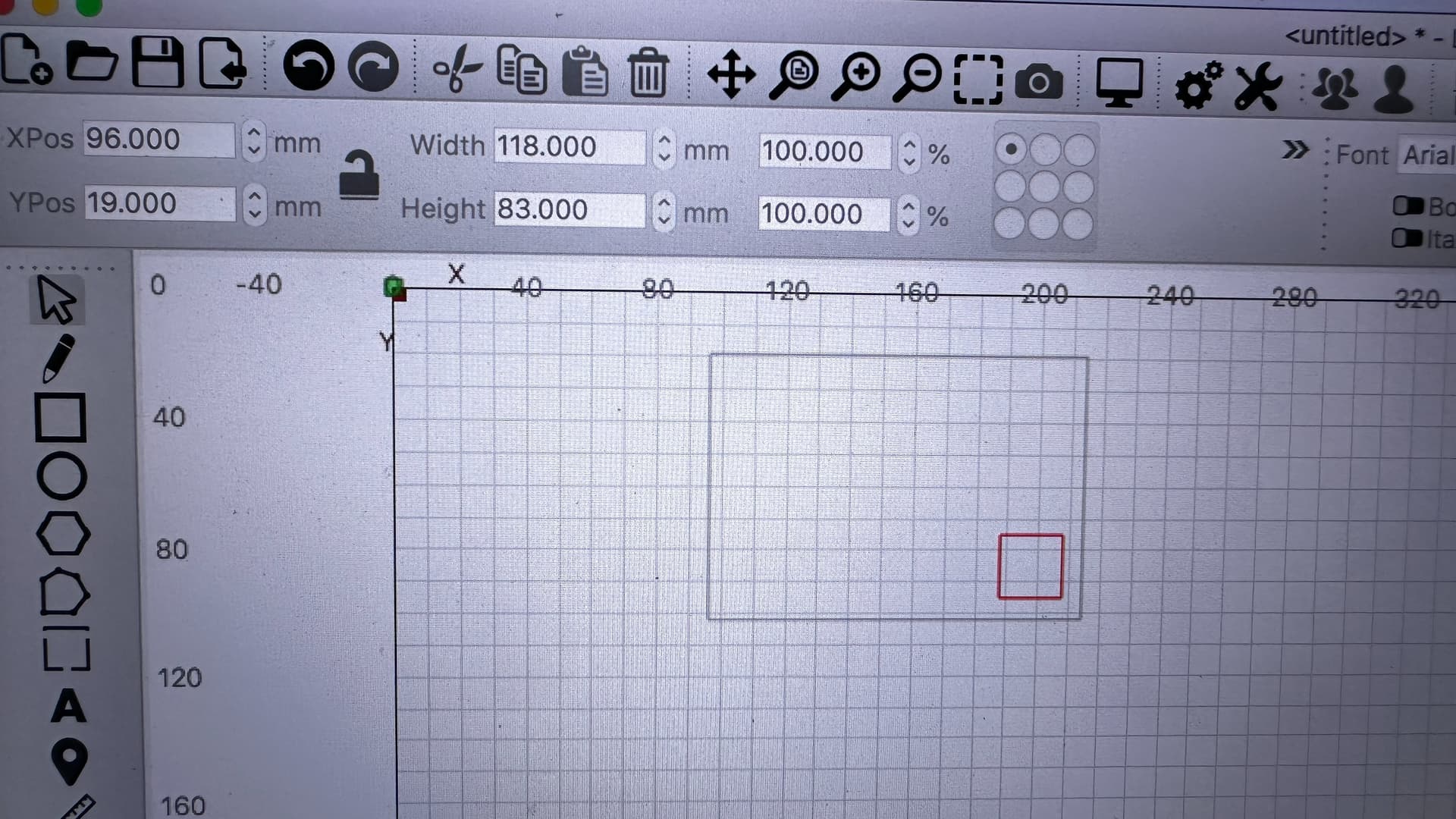

Yes the shape is not symmetrical but did test on a square and it too was about 5mm out on the x axis and the same if flipped vertically. Just cant get my head around it. I have an outline exactly the size of my wood thats sits firmly against a fixed two sided jig at exactly X96mm Y19mm so it goes back in the same place but when both the wood and lightburn image are flipped it is still out. yet on the screen its exactly in the correct place.

If I flip the wood over then the shape cant be overlayed as its mirrored and just flipping it seems to move it out of sync. I just cant workout why this would happen.

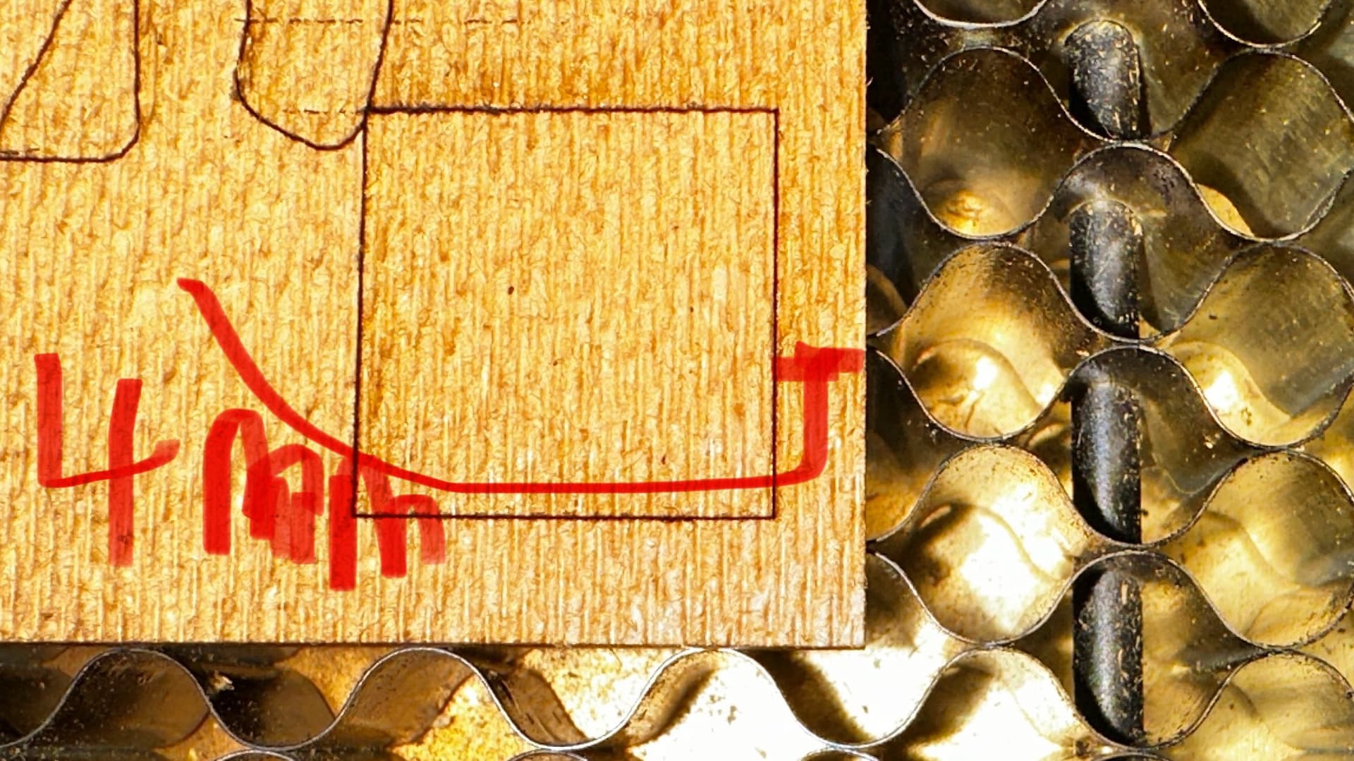

I think when I did a square of 20x20mm the second cut on the opposite side was 4mm further along on the x axis.:+1:
Heres what im doing, dont know if this will shed any light on the problem?
Ahhh, it helps me to understand. But I can’t reproduce your problem.

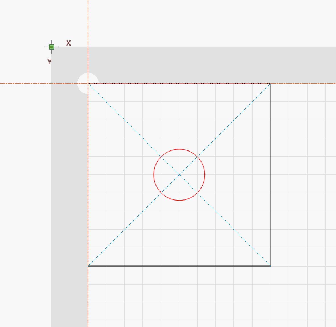

Turns out the issue was the crosshair was out and had to be offset in the settings. Hadn’t noticed it until I was trying to centre a shape and my original mirroring alignment issue.
Both now are spot on and the slight measurement anomaly also seems to have gone.
