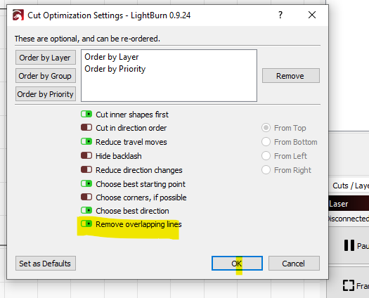

So I am often cutting huge amounts of text, when possible I am moving letters closer together to reduce laser time. The problem I am having is that sometimes the machine will cut the outer border and then try to separate the letters which obviously doesn’t work very well as the letters have fallen into the tray. Just wondering if there is a setting or trick to avoiding this when setting up jobs.

Don’t have it cut redundant lines, under optimization use “remove overlapping lines”.

Thanks for the reply, I have the remove overlapping lines setting selected. Would rather not use tabs as the client wants a very perfect polished edge.

@joey333 It’s hard to tell from the picture exactly what it is you are printing.
Are the letters NIIIIR? I assume you’re saying it’s somehow cutting the outlines of the entire group of letters thus allowing that group to fall through rather than cutting out one letter at a time?
If so, you should take a look at the Order by Layer, Group, Priority component of the Optimization settings. The “Cut in direction order” might also be relevant. These should allow you enough control to force the cut order that you need.
If this is not what you’re describing can you provide some more context?
