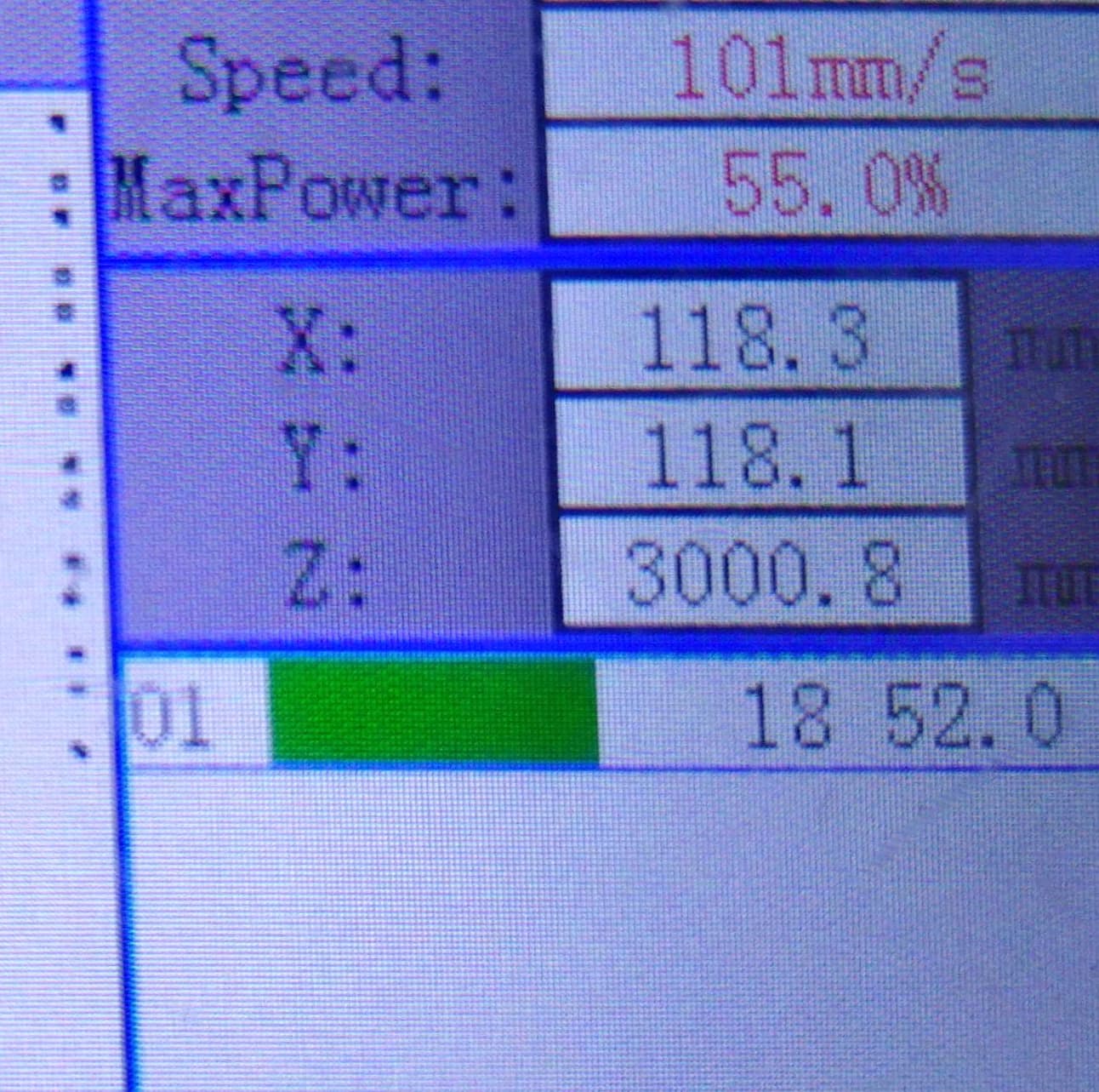

If i sent a laser cutting job to Lightburn 0.9.23 from CorelDraw the laser cut result isn’t good.
Some holes are good and some have a really strange shape.
On the UI in Lightburn the strange shapes are not visible, and in the preview everything looks normal.

Also, can you confirm what control panel showed after you burned the shapes? Do they show a proper circle or does the panel reflect the odd shape burned?
At first glance this looks like a communication issue but don’t see why this would only happen with LightBurn and not RDWorks. Can you confirm the connection to the laser is the same irrespective of program used?

The connection was exactly the same USB.
i didn’t save the file because i always sent the file to the controller ad cut directly.
But now when i cut the same file the there is no problem. Really strange
I will keep an eye on it and use Lightburn more if it happens again i will save the file and upload.

Now it when i cut it multiply times it going wrong.
i sent the file every time to the laser and see what happens.
i stop the processes if it is further then where the error is.
Then move the sheet and sent i again to he laser.
If it went wrong and i don’t sent the program to te laser gain but pres start the same fault shows up Pictures are rotated.
So it looks like the problem is there when sensing the program to the laser.
On the screen i cannot see the problem
But it is to small to see it for 100%
Try this. Take the existing design that you say is repeating the problem when you press start. Then push “Save RD file” in Laser window and save to a file. Copy that file to a USB drive.
Connect USB drive to controller and run file from there. Does the issue remain or does it go away?
