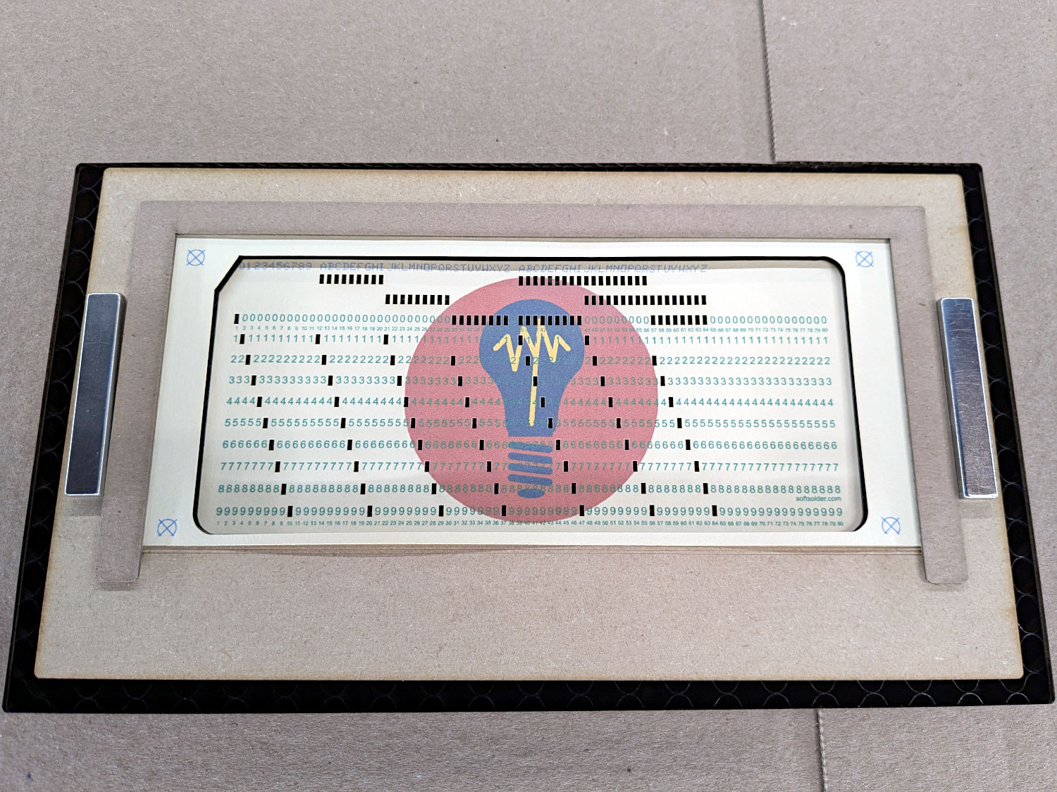

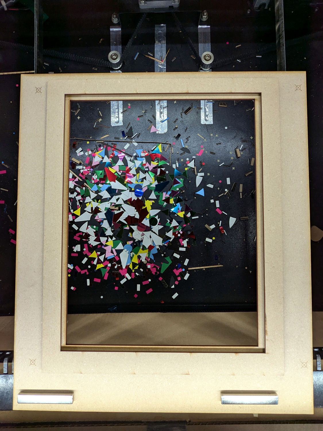

Being a big fan of fixtures, I’ve found raising the material just a few millimeters over the honeycomb suffices to reduce the blowback:
The chip tray has cutouts from the MDF fixture spanning the blades:
Sometimes you can let the cutouts fall free through the fixture:
Letting pieces I want fall out, even by a few millimeters, has never worked well, because the next laser pass inevitably torches them.
Dunno about fixtures for your giant acrylic sheets, but if you can prop them off the blades just a little, that might be enough.

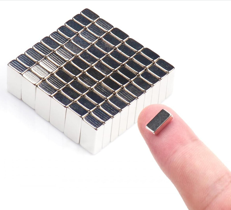

The local steel place cut one to fit and cost me $12 USD. I put it in the machine and used the laser to mark drill/locating holes for jigs. I do mostly engraving but I do cut, I stick 5x20x2mm magnets to lift it up 5mm. You need to allow the gasses to get out.

Edit: I also have some bitty 1mm thick magnets which might be a better choice.

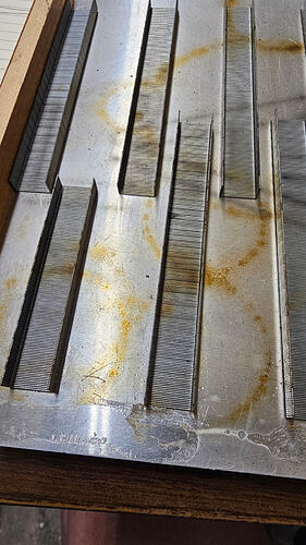

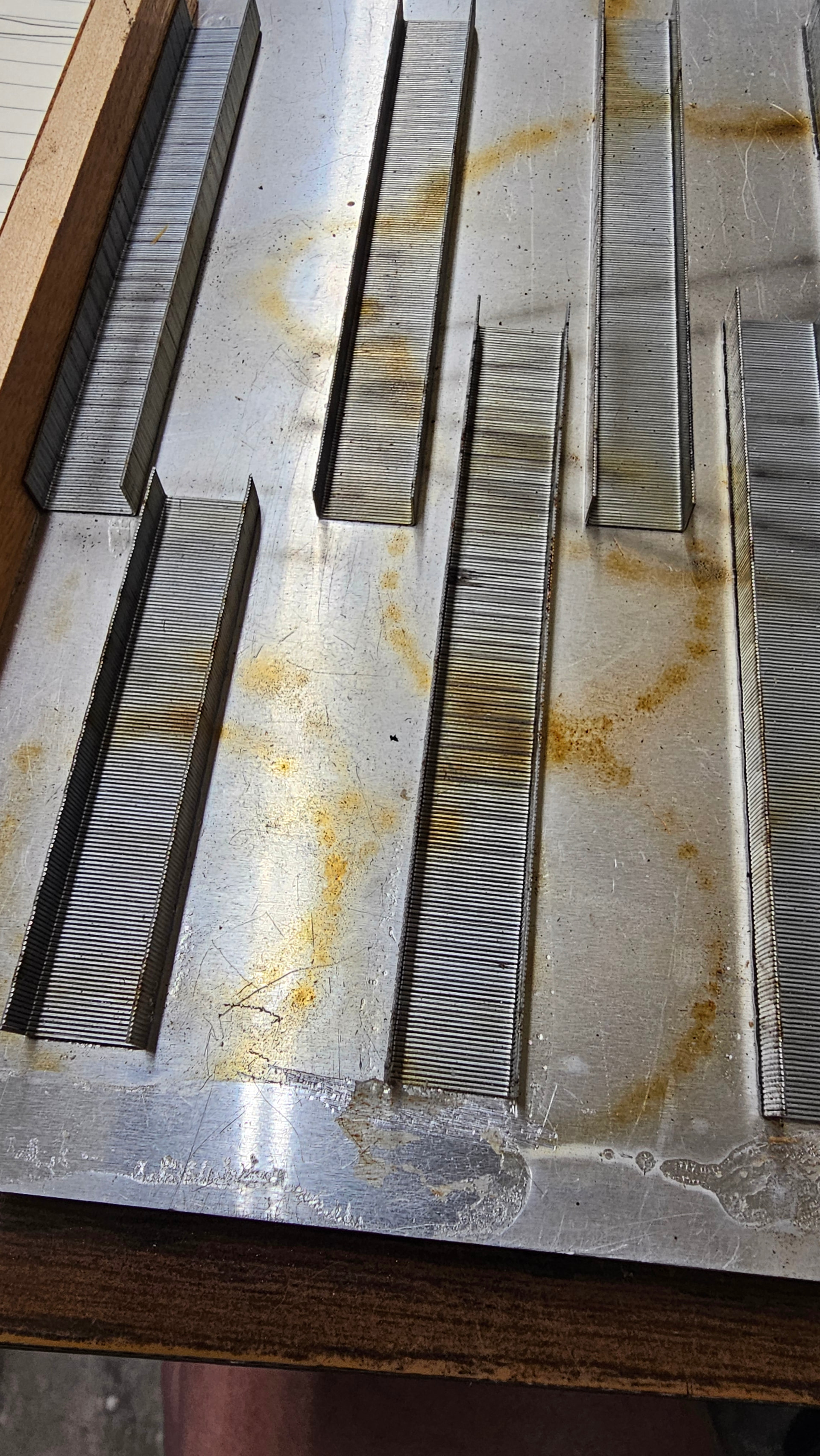

I use a metal plate with staples placed on top. (turned over staples). There is less area contacting the material.
