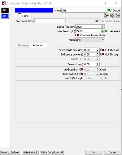

There is an “overcut” option under advanced tab of cut settings editor window.
Often, that first penetration when you start a cut does not make it thru completely, and the overcut option kind of just finishes off what was started.

Hi . Thanks for the reply. I have the latest version Lightburn installed and tried what you said. The overcut option is under the advanced mode in line. I started with an overcut of 1mm…no succes. I even got it up to 20 mm without any change. If i look at the preview of the thing i am cutting holes in there must be a difference in estimated time between a normal cut (without overcut adjustment) and with overcut( with even 20 mm overcut). The laser time remains equal for both…thats impossible if overcut actually works as it needs to go 20 mm past the normal cut. It does not work at all.

As i understand ( by hovering the pc mouse over overcut option) the overcut only works to cut out closed shapes…so just a straight line would not be overcutting. I tried a few different things allready( all closed shapes) …but found there is no difference in time used or distance traveled between parts with or without the overcut active. I am now trying the start pause time and end pause time that can be set in microseconds. Its right above the overcut option. Maybe that could help some as the laser is than set to have a bit longer output at the start and finish…maybe burning trough the small part that otherwise does not cut. For bigger shapes its not a problem the parts have a small point that does not cut fully , as those parts allready drop out by their own weight. But i use this laser often to cut out tiny sewing holes ( from 0.8 to 2mm circles) in leather…if i need to clean out all holes after laser cutting it takes a lot of effort and they are stubborn. Until i solve this problem i use fill instead of line on those tiny holes. That takes the laser a fair bit more time but at least the holes are fully open.

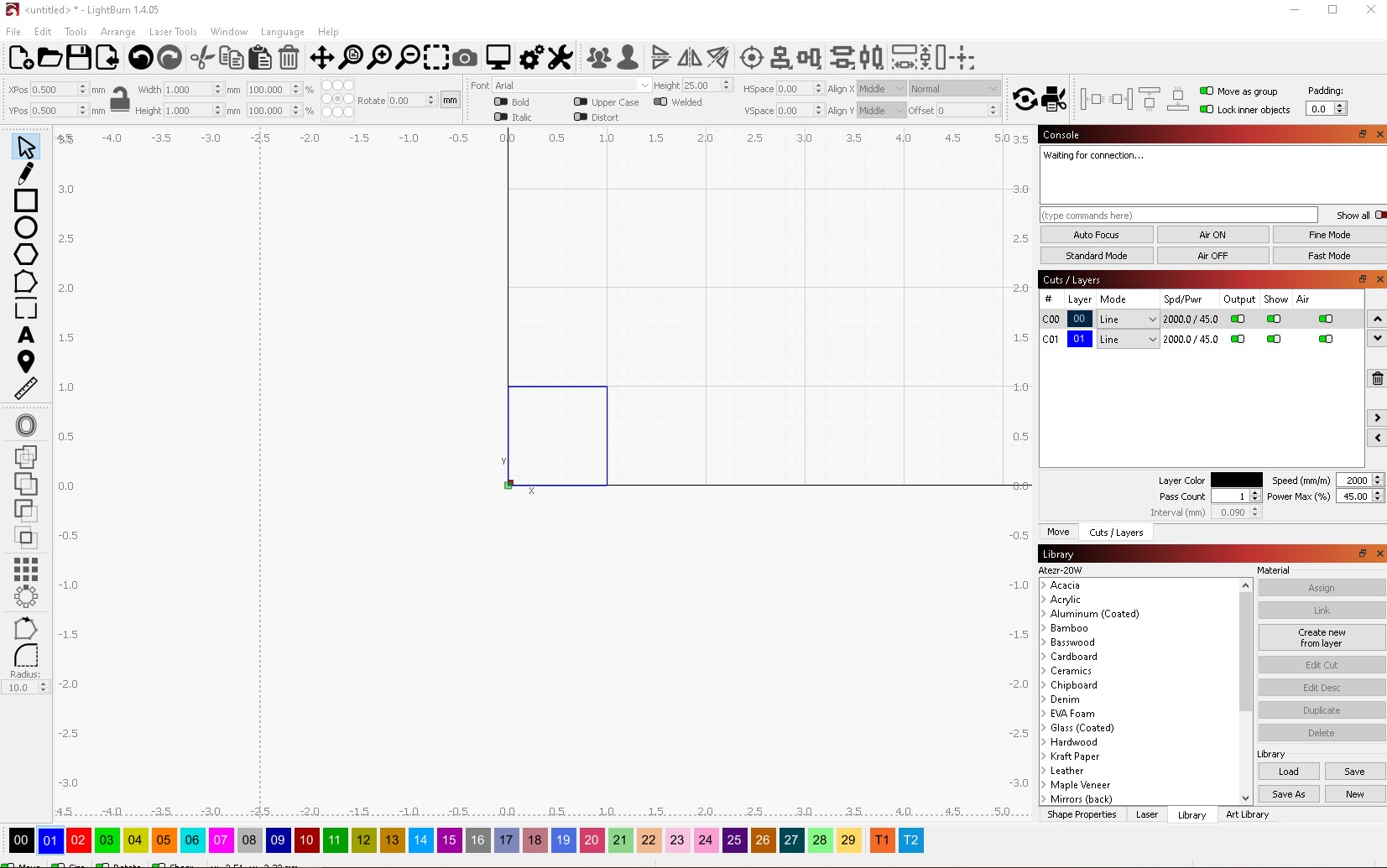

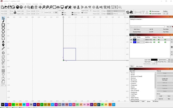

Out of curiosity, I made a very simple program with two identical, overlaid layers with the exception of one layer having overcut.
It’s two squares of 1mm placed at 0,0. C00 has .2mm of overcut. C01 does NOT. I then previewed and saw no difference, so I saved the gcode and looked at it. The two layers are NOT the same. Notice the extra move of .2mm in the first layer (bold). Circles of 1mm produce a similar difference but the math is more difficult to suss out the exact difference.
I suggest trying it on a real test job.

Do you have max and min power settings the same. If not, beam power may be dropping to the min power setting as the beam approaches the end of the cut.
Hi , thanks for reply. Not sure were that max and min power setting is…could not find that. Maybe a printsreen to locate where i can set those?? I have constant power mode enabled in the layer popup when cutting in line mode.
For a diode machine, Min/max is only available on grayscale image mode. I believe it’s a standard setting in all modes on a CO2.
