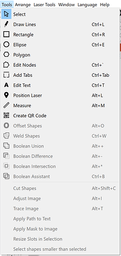

Cylinder Correction not showing despite having galvo license
Hi, I have all licenses (GCode, DSP & Galvo), but despite that, the Cylinder correction tool does not appear in any menu.
Have you created a galvo device profile and selected that for use? If not, that option will not show.
You’re right on the money. The option indeed only shows when the galvo profile is selected. I didn’t notice it since I do most of my designing on the DSP setting.
