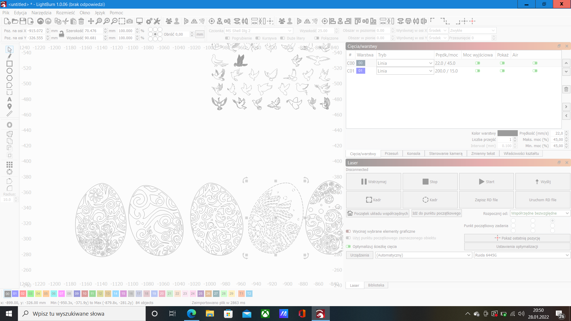

Witam od dłuższego czasu mam taki problem robię projekt w programie i nagle zawieszka i długie myślenie programu? Pomocy wcześniej tego nie miałem
Hello, I have had such a problem for a long time, I’m doing a project in the program and suddenly a hang and a long thinking about the program? I didn’t have this help before
When does this occur? Are you perhaps using a Filled view style? This can be much slower if you’re working with a very complex design.
Please upload a sample file if this is specific to a file.

i znowu chwila pracy i myśli myśli… Już mam dość… świerzo zainstalowany na nowym kompie …Myślałem że stary nie wyrabia a tu to samo
and again, a moment of work and thoughts of thoughts … I have enough … freshly installed on the new computer … I thought that the old one is not working, and here is the same
What you’re seeing is very unusual. LightBurn is normally quite fast. Load times for a file are typically under 1 second.
The file you’ve shown looks quite complex and may have a lot of small lines. Can you upload the file here for review?

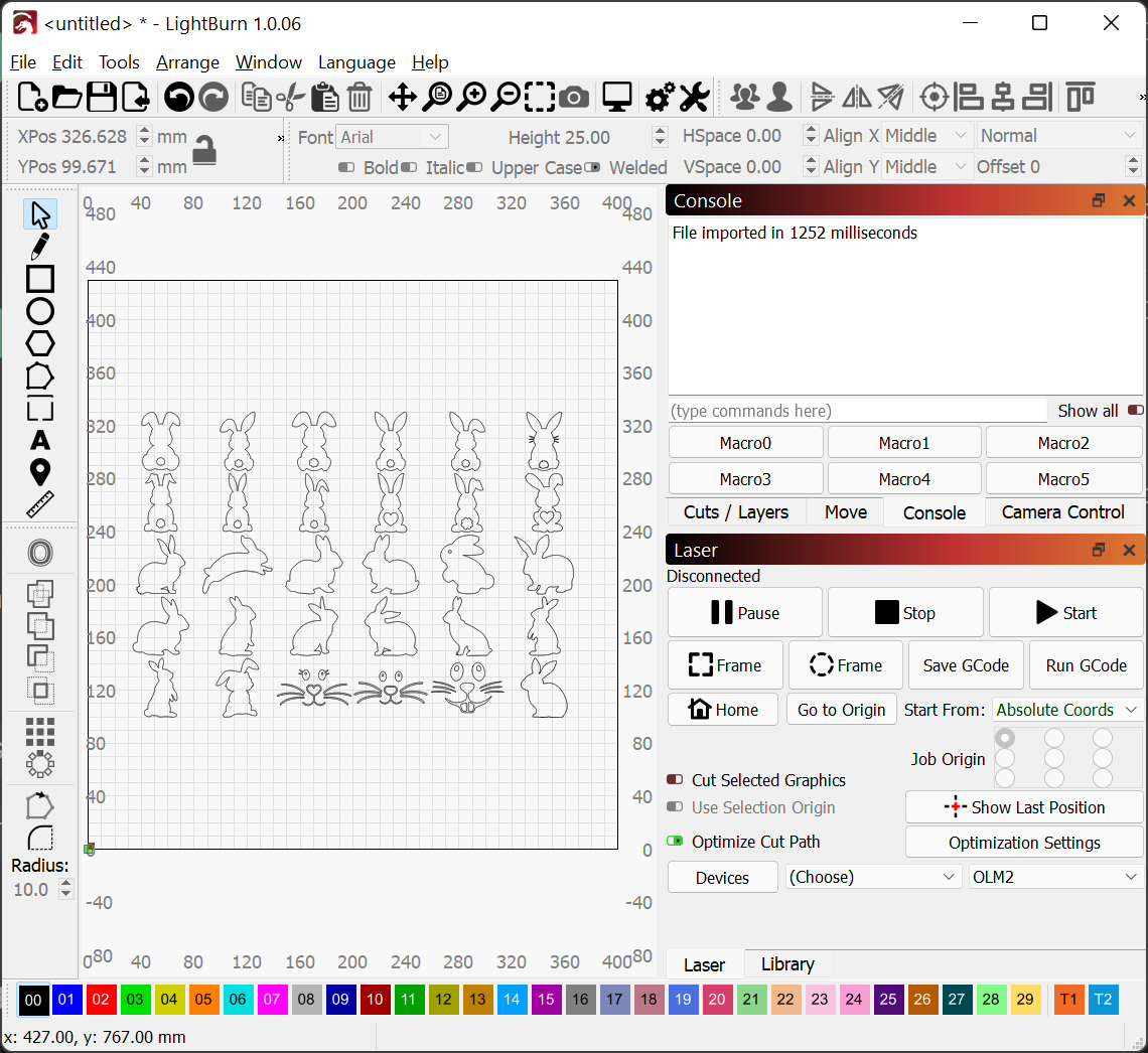

Easter Bunny.dxf (940.1 KB)
That file loaded for me in 1252 ms. I’m not having any issues with pauses.
I’m suspecting you might have an environmental issue in this case.
