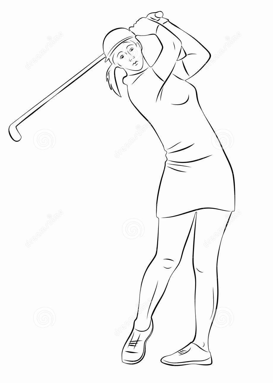

Darker vector lines
I’m doing a golfing project with a vector image. The engraving is going on a wooden box top. The customer doesn’t want the image filled but wants darker lines. Is there a way to accomplish this?
Darker wood = longer dwelling on the material. This is the dance of power, speed, and material because as you decrease speed for longer dwell time you may have to reduce power. What you find ideal for one species of wood or brand of material, will differ from another. What works on one area of the natural product, will be different throughout the surface because of grain and density variations.
The short answer is, however, to make the effect darker on wood, slow down the speed.
Thanks, I’ll give that a try.
