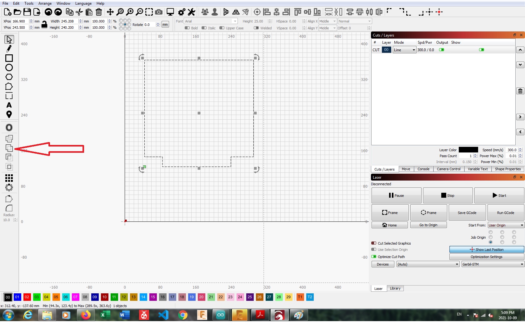

De lijn verwijderen
rechthoek
how can I remove the line between the 2 rectangles so that it becomes 1 whole
thank you Ronald
select all
control-b (boolean assist)
select option example
Thanks for the reply
but nothing happens to me when i do this
Thanks this will work
Select both rectangles and click on the option specified in the image
pay attention, the parts must touch each other to be able to use the boolean operations (which is the easiest way to perform your desired task)
