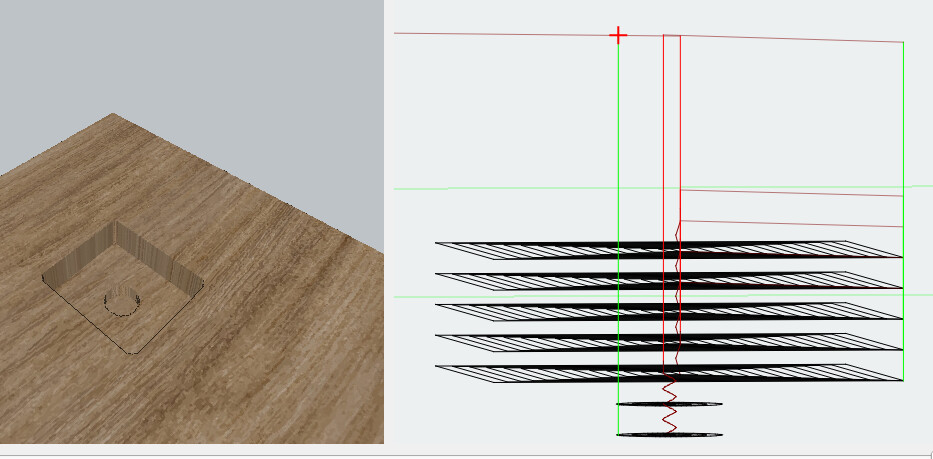

Why might you want an SD other than zero? In the example below the goal is to cut a square pocket 5mm deep, followed by a round pocket 7 mm deep.
The first operation for the square is a pocket with an SD of 0, DP of 1mm, and final depth of 5mm. The second operation (for the circle) has an SD of 5mm, DP of 1, and final depth of 7.
In the preview, you can see the result and the two operations, with the second one starting at the bottom of the square pocket.

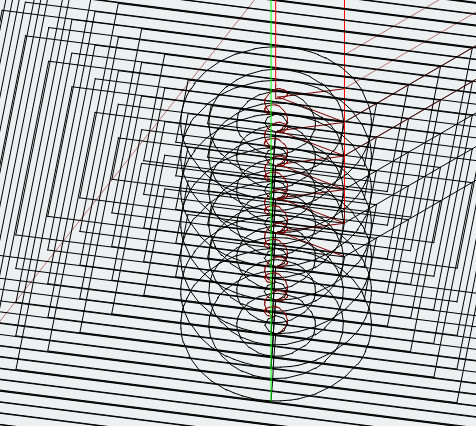

If the SD for the circular pocket had been left at 0, then there would be air cutting from the top of the material down to 5 mm, as shown below.
