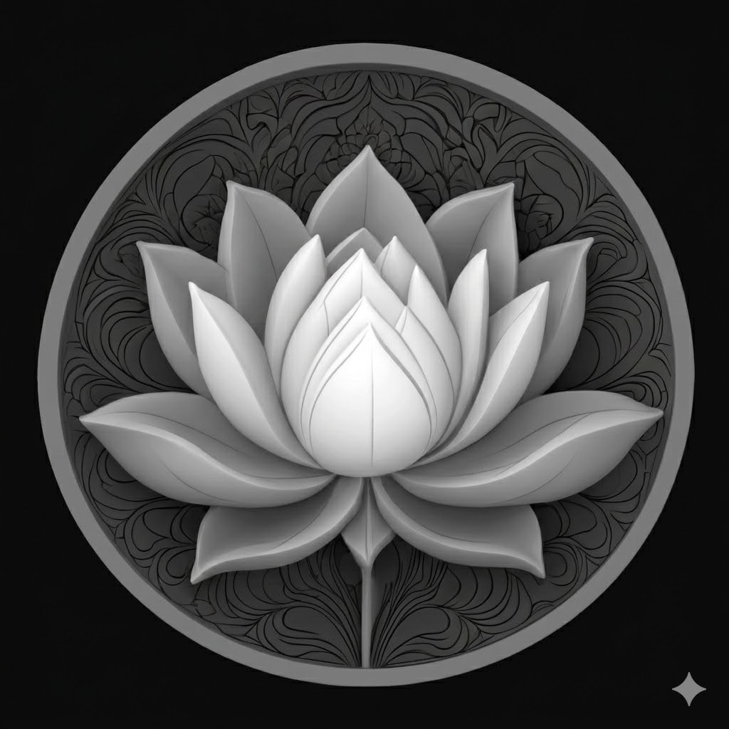

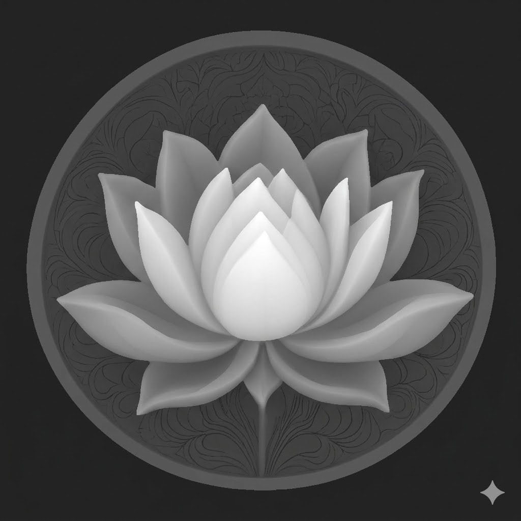

Playing around with Google Gemini, generated some maps but it outputs all the compression artifacts as well. Haven’t tried engraving yet, just seeing what is possible there.
Input image:
Outputs:
Not sure how will engrave, any comment from people experienced in depth engraving ?

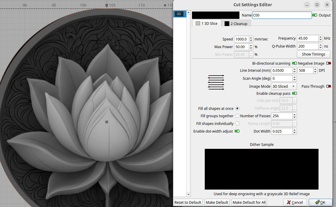

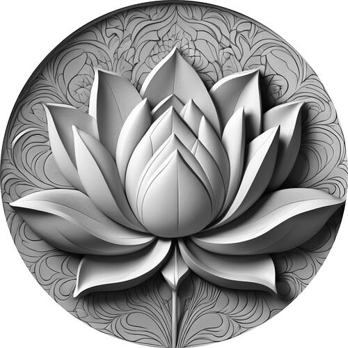

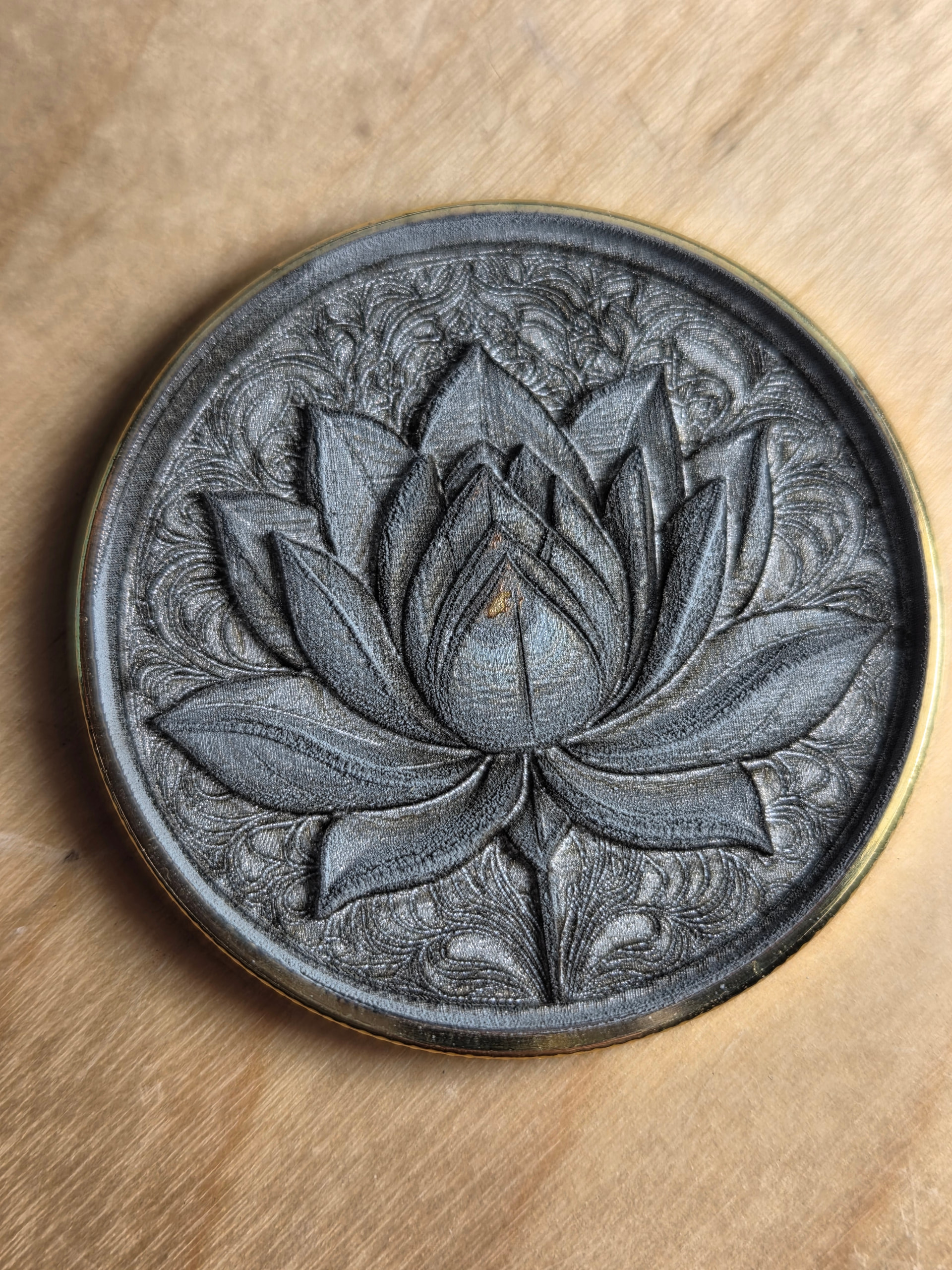

Seems to look OK, I’m just recovering from a two disk crash. I just guessed at the settings. Used your second photo.
M60 JPT M7 MOPA - F254mm
That steel coin ? how deep did it go, how long did it take with these settings ?
Actually it’s a brass coin from Amazon. They are generally quite yellow. I probably was running too much power at 50% causing the metal to look more burnt.
Took about about 100 minutes (1:48).
I’d guesstimate a bit over one mm for depth, they are 3mm thick coins.

Yeah, my first try at coins was a disaster :smiley: brass dont stick to magnets…
