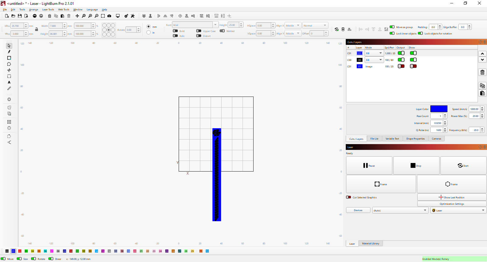

I have been engrave on 254mm lense and moved to 100mm lens. my work space for 100mm lense say for calibration is 70x70mm at the center of the anchor is the top dead center of my burn line. I didn’t change anything other than calibrating the lens workspace. Calibration using old, but engraves fine, just missing the other half. How do center my logo at top dead center, but still engrave the part outside the workspace. “Ignore out of bound shapes if possible” is set to off already. What am i missing. Do I need to move my XY axis up to other anchor center?
So my ring engraves the center logo, and half the rope, the other half of the rope is outside workspace and won’t engrave, but its a rotary so it should just rotate and engrave. Total diameter is 85mm so its going to go outside 70mm workspace even if I center everything.
ok i figured it out, make sure you do a full lense calibration, fix the scale, and make sure rotary wasn’t reset. The step size for rotart was reset to 500 when it should have been 12800 and when you test should make a full 360 rotation
