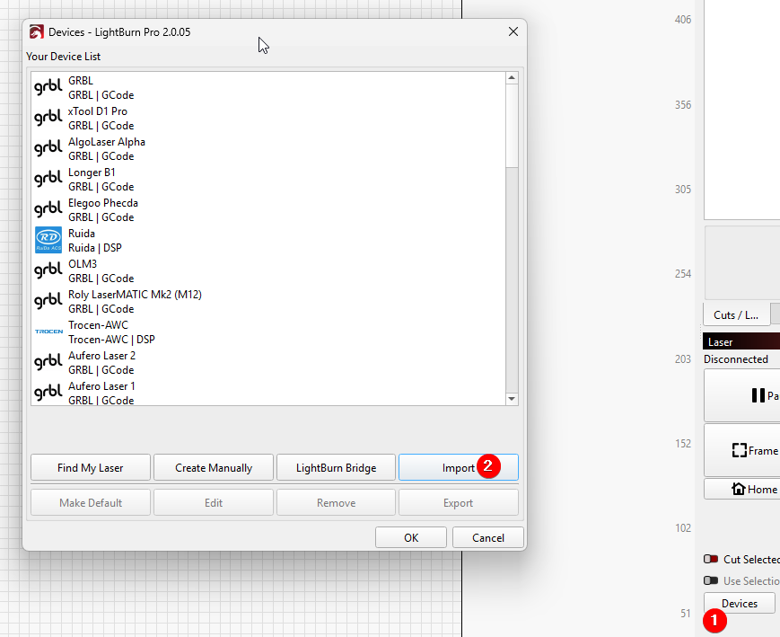

In the Chinese language version, when right-clicking on a device in the laser section to access the device list and then clicking “Import,” a file selection dialog box appears to choose the lbdev file. However, the dialog box displays the file extension as “. lbdev” instead of “.lbdev,” with an extra space after the period. This prevents the system from finding the file in folders containing .lbdev files.

2.0.05 correct?
Then Click Device button > Import

I am not able to replicate on 2.0.05 or RC2.1
Hence why it would be helpful to confirm the version when possible.
The language needs to be changed to Simplified Chinese, otherwise, it cannot be reproduced.
