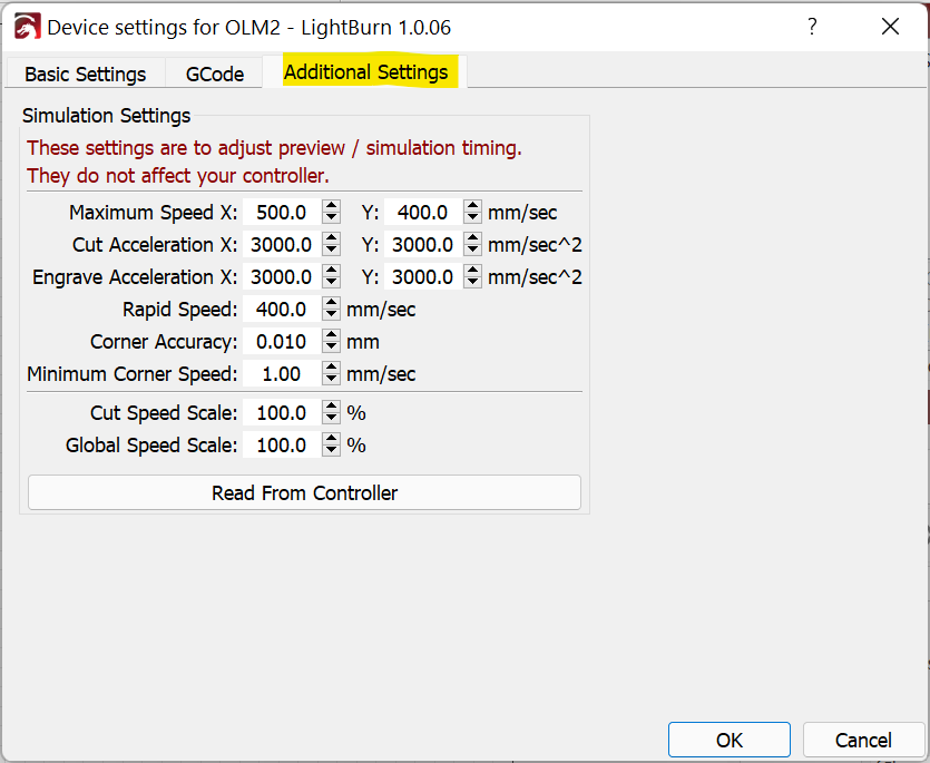

Hallo, die errechnete Zeit in Lightburn stimmt nicht mit der wirklich benötigten Zeit überein. Lightburn: 3 min Wirklich: 13 min
Kann ich das einstellen ?
Hi there, the calculated time in Lightburn does not match the actual time required. Light burn: 3 mins Really: 13 minutes Can I set this?
Can I set this?
LightBurn uses the values in Device Settings->Additional Settings to calculate the estimated time. Minimally you could try reading the values from your controller to help improve the numbers. Otherwise you could tune the numbers yourself.
