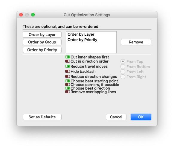

Did you have Optimize Cut Path enabled? What are your settings there?
Screenshot 2022-01-09 at 18.18.57
Okay, with Optimize Cut Path on with those settings I get the same Preview.
You’re certain you had Optimize Cut Path on when you did the burn?
If so, wondering if the Optimizations are not being considered when sending to laser. That should be pretty obvious though.
