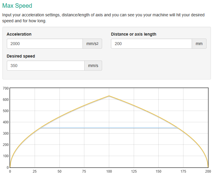

Yes, this will be the case. You are using high speeds. I don’t know the acceleration capabilities of your machine, but in case it’s around 2000mm/s², it would take about 30mm to reach the speed at all. If you have 5mm squares, you will never reach it.
 ![image](https://forum.lightburnsoftware.com/uploads/default/original/3X/f/c/fc4acacf632d7b4d3a828a125785af8072f53778.png)

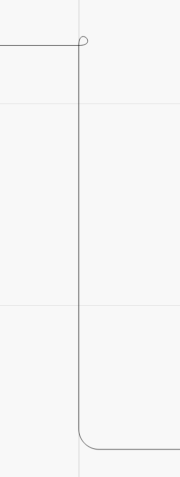

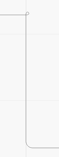

Because those boxes don’t have square corners:
 ![LightBurn - boxes.py loop corners](https://forum.lightburnsoftware.com/uploads/default/original/3X/3/d/3dbc6789b07d737c7b6d135f7d861e3138f9f1b2.png)
The tabs have rounded outer corners and the little loops mean `inner_corners` was set to `loop`.
So, unlike in the test pattern, the controller won’t slow to (almost) a complete stop at the corners. The loops may toast the inner corners a bit, but that’s in the nature of fine tuning.
