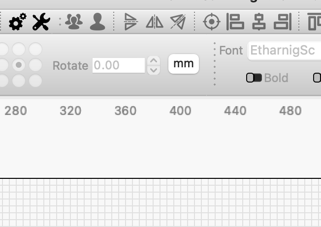

Salutations. When I create a figure with lightburn for example a 10 mm x 10 mm square he engraves it for me in inches. How can I solve? thank you

… you just press the ā€œmmā€ button and you will get inches

Can you take screenshots demonstrating this please? Preferably with full size screenshots covering the whole application.
The machine is set to inches…
$13 = Sets position feedback units from mm to inches. $13=1 for inches or $13=0 for mm
Software and machine talk in ā€˜units’. They need to be the same ā€˜type’ at both ends.
ā€˜Edit → Machine Settings’ and change ā€˜Report Inches’ to false. Write it back to the controller…
While you are there, save a copy of the configuration…
