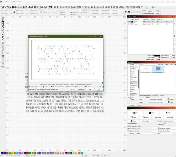

Hey, ya’ll. I am admittedly new to the program and lasers entirely, however, I’ve run into something that I just can’t find the answer to with all of my poking around. I hope you can help!

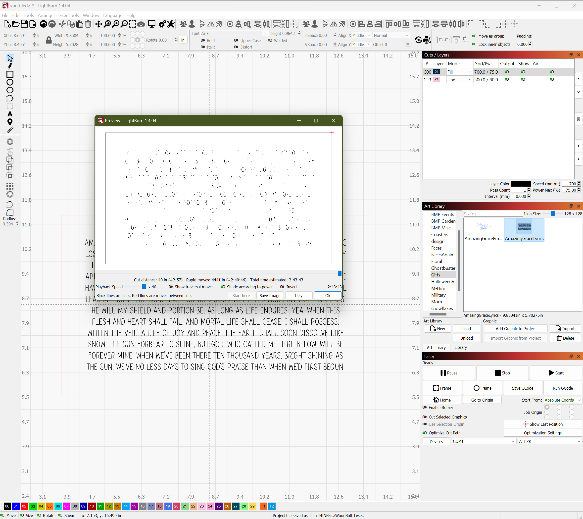

I’ve attached a screenshot of the issue. Specifically, the text -preview- is garbled (and is burning garbled to match the preview) but only when I have the layer set to “fill.” Whenever it is on “line” it is working juuuuust fine. I’ve tried the ‘read from controller’ button, I’ve looked at the kerf, I’ve mucked with settings galore, and I’ve downloaded a fresh version of the file.
I know this is user error because it worked fine last week. I’d leave it alone entirely, because it IS really thin text, and 'line" should work - but It DID work last week on fill.
I appreciate your time and your help.

You’ve got a bit of an oddball situation going on here.
The reason you’re not getting usable output in Fill is because of the way that the letters are constructed.
At first glance they letters appear as though they’re made of open line segments. The important part being that they don’t appear to have closed areas.
So when the Cut setting is set to Line it appears to work correctly.

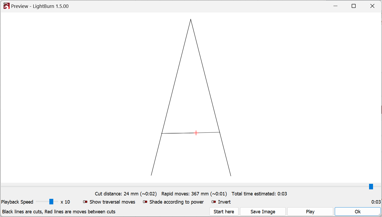

However, if you play through the Preview you can see that the laser path is quite strange for a line and all lines are traced twice:

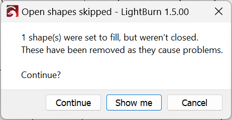

Normally, you wouldn’t be able to preview open shapes set to fill. You’d normally get an error like this:
The fact that you don’t get this with the text is a clue that something else is going on.

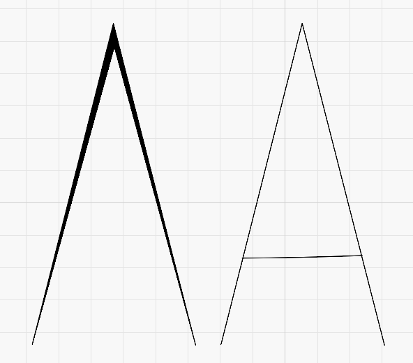

Upon closer inspection you can see that the individual lines are in fact made up of a closed shape with very strange arrangement such that it approximates a line.
In this screenshot I’ve duplicated the arch of the ‘A’ shape, and pulled away the top middle node using Node Edits tool to reveal the closed shape.
As a workaround you might be able to salvage this by selecting the shapes and then applying a very fine offset to provide thickness to the lines.

You are using a single line font that should only run as a “score” or in the “line” mode with less power. It looks like it isn’t a true single line font. Not sure if you used a font, or bought it this way, but it has a lot of extra lines that are almost overlaps.
If you select everything and break apart, then delete duplicates, it looks the same, but will not allow fill since it is all open shapes.

Running preview after what I said,it is all over the place for burning. Probably better to find a SHX font that is close and start from scratch.
