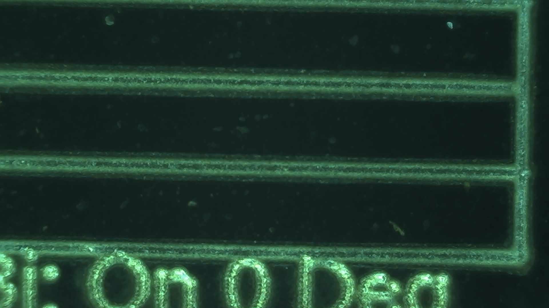

Just thought I’d throw this in, what do you think?

So under the microscope you can see the difference between the start and stop timing , “Matchstick” (circled) indicates the beam waited just a bit too long, compared to the end pointed at with the arrow.
So IIRC the first line up goes from left to right, second line up is the return, so the Off TC needs to be reduced just a tiny amount. Start looks good.
