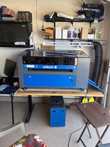

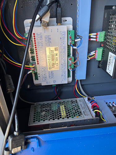

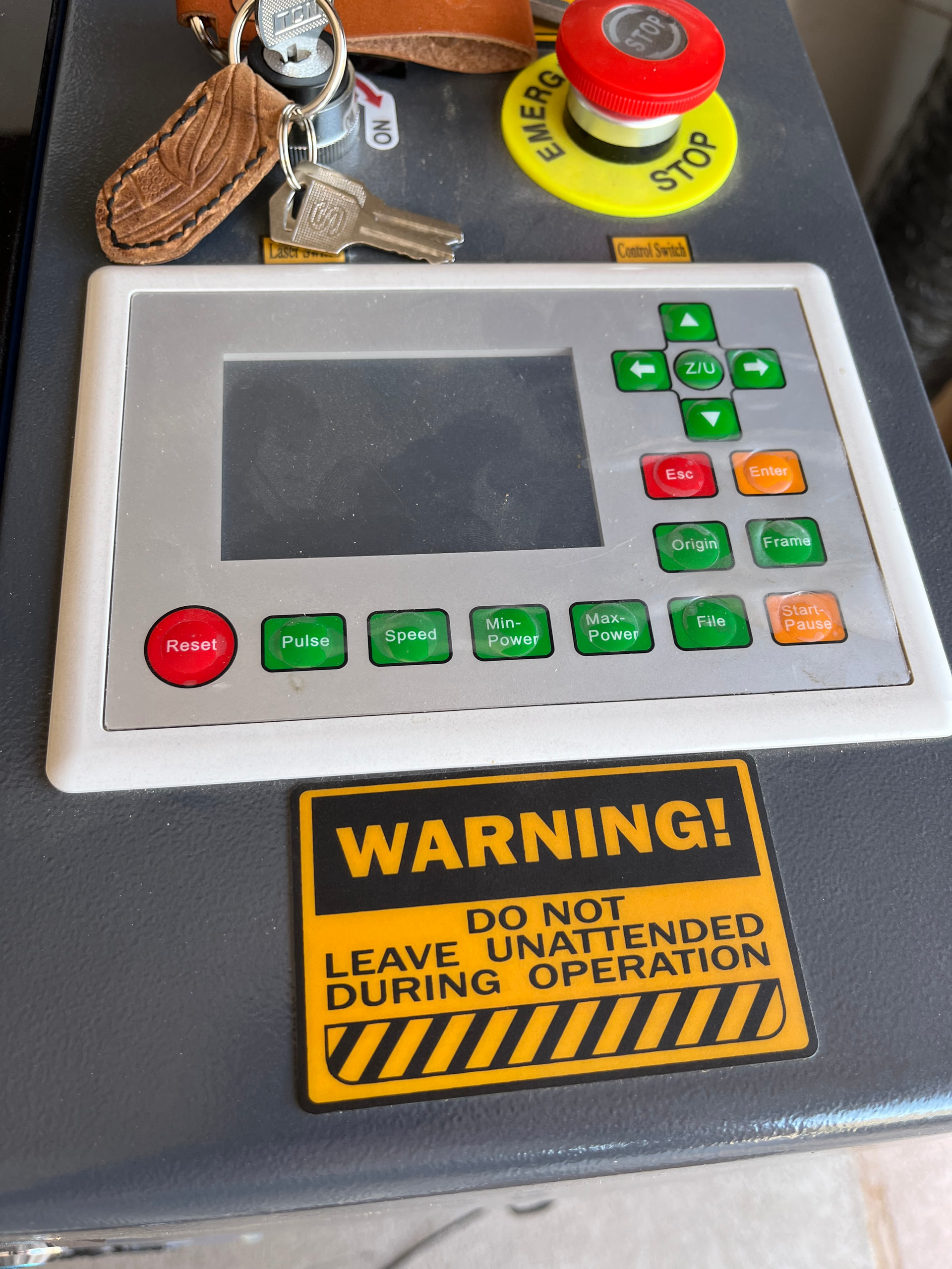

So in my other post I explained that I could not communicate between my laptop and laser. It will now work if I draw a box and cut it out. But if I try a file the controller beeps once and then it says busy paused It does this in both lightburn and rdworks. I’m guessing I need a new controller? Any help is appreciated.
Check if the memory of the controller is full and clean some files.
Please do not reset the controller NEVER

The files are in the controller, not Lightburn. Conrtoller connected?
I deleted all his files when I got it home. So the Laser itself has no files on it.
- Confirm Windows shows a COM port containing CH340 in the text when you plug in the laser. You should also hear a tone.
- Make sure there is no other software running, like RDworks(?), when you make the connection.
