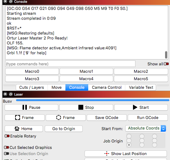

Thank you. This is what the $RST=* command returned.
$RST=*
[MSG:Restoring defaults]
Ortur Laser Master 2 Pro Ready!
OLF 155.
[MSG: Flame detector active,Ambient infrared value:4091]
Grbl 1.1f [‘$’ for help]
However, the status bar says Busv and is completely blue even after 10 minutes of waiting, so I can’t make the laser do anything. It looks like I need to upgrade the firmware right away.

That’s a little odd. You may need to power cycle the laser or at least force a reconnect by right-clicking Devices button in Laser window.
Just finished updating the firmware, the origin is now at X0 Y0 when homed and the $RST=* command works perfectly too!
Thank you so much for helping me out!
