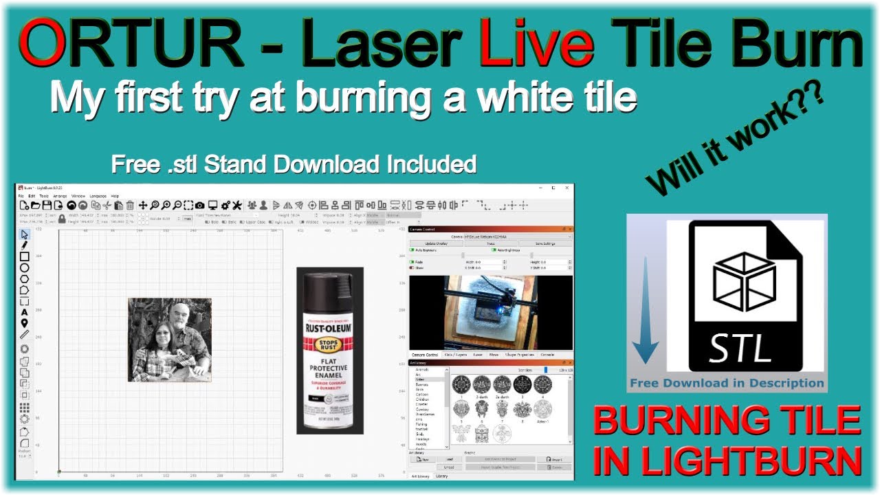

**My answer is an emphatic NO!**
I tried it for the first time today, and **I didn’t do ANY IMAGE PROCESSING!**
I had a feeling all these posts on Facebook and other platforms were B.S.
Here’s the result of just slapping on a tile and burning it:
 ![dual](https://forum.lightburnsoftware.com/uploads/default/original/3X/c/2/c2221295a1c0ee761e4b1bede8c6d1d665e5b8eb.jpeg)
Yeah, Lightburn can do that.
What do you think?
Video out tomorrow of the quick process…

[![](https://img.youtube.com/vi/4pSYgzlcS6o/maxresdefault.jpg "Diode Laser Burning an Image on White Tile") ](https://www.youtube.com/watch?v=4pSYgzlcS6o)

Lightburn’s photographic capability is a lot better than people realise. But some photos need tweaking if you need to lighten just a small spot here and there.
All the steps out there are now obsolete, but people continue to make money off the uninformed.

I think for a first attempt it came out great.

Thank you all for the replies.
I buy my tiles from Lowes and the process is as follows.
1. Give each tile a wipe with a paper towel whetted with Acetone.
(you would be surprised what can come off of them)
2( Paint with the white primer
2. Burn the tile
3. Wash with Acetone to get all of the paint off.
This is the results.
The Image will not come off by any means.
I tried using Gimp and Imagr,
I simply don’t get the results that others have.
I strictly use LightBurn for all of my work.
But again, It is my understanding that its the titanium dioxide in the white paint that gets burned into the tiles.

Sorry, I forgot to mention that the best thing you can do is to produce a test tile so you can find the “sweet” spot for your laser.
As you can see, mine is at about 20 IPM at 30% power.
J-Tech Watt Pro.
