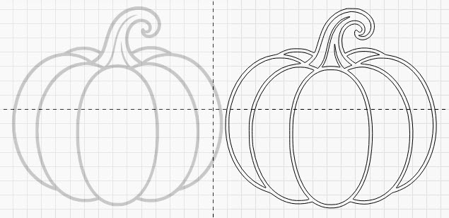

Often when i do an import it comes in as double lines instead of single lines. I know what causes this but is there an easy way to correct this.

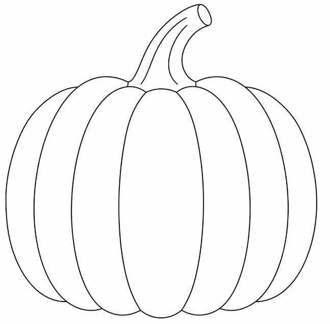

I figured this one out. Just used AI to generate my image with a 1mm line width. But that still doesn’t solve my issue when i am importing a predesigned image

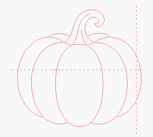

If you’re usig pro try a Center Line trace.

> [@parsec](#):
> Center Line trace
If you have not done so, you will need the RC (release candidate). This is not in the production release yet.
Or just use mine. Be aware it may need some touchup work.
[Pumpkin CLT.lbrn2](https://forum.lightburnsoftware.com/uploads/short-url/oEIgUXmf1Xm2hzHvPCxEN4RzADa.lbrn2) (195.1 KB)

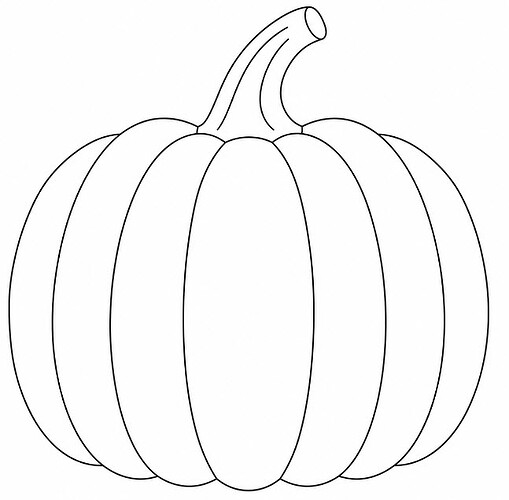

Here’s my final design
 ![Simple Pumpkin](https://forum.lightburnsoftware.com/uploads/default/original/3X/c/6/c6810505dea9886c2ed3137d97283c0294ac3fbb.jpeg)
[Simple Pumpkin.lbrn2](https://forum.lightburnsoftware.com/uploads/short-url/7n2IDIcZuSreKSPqTTa145Jyiqf.lbrn2) (151.1 KB)
