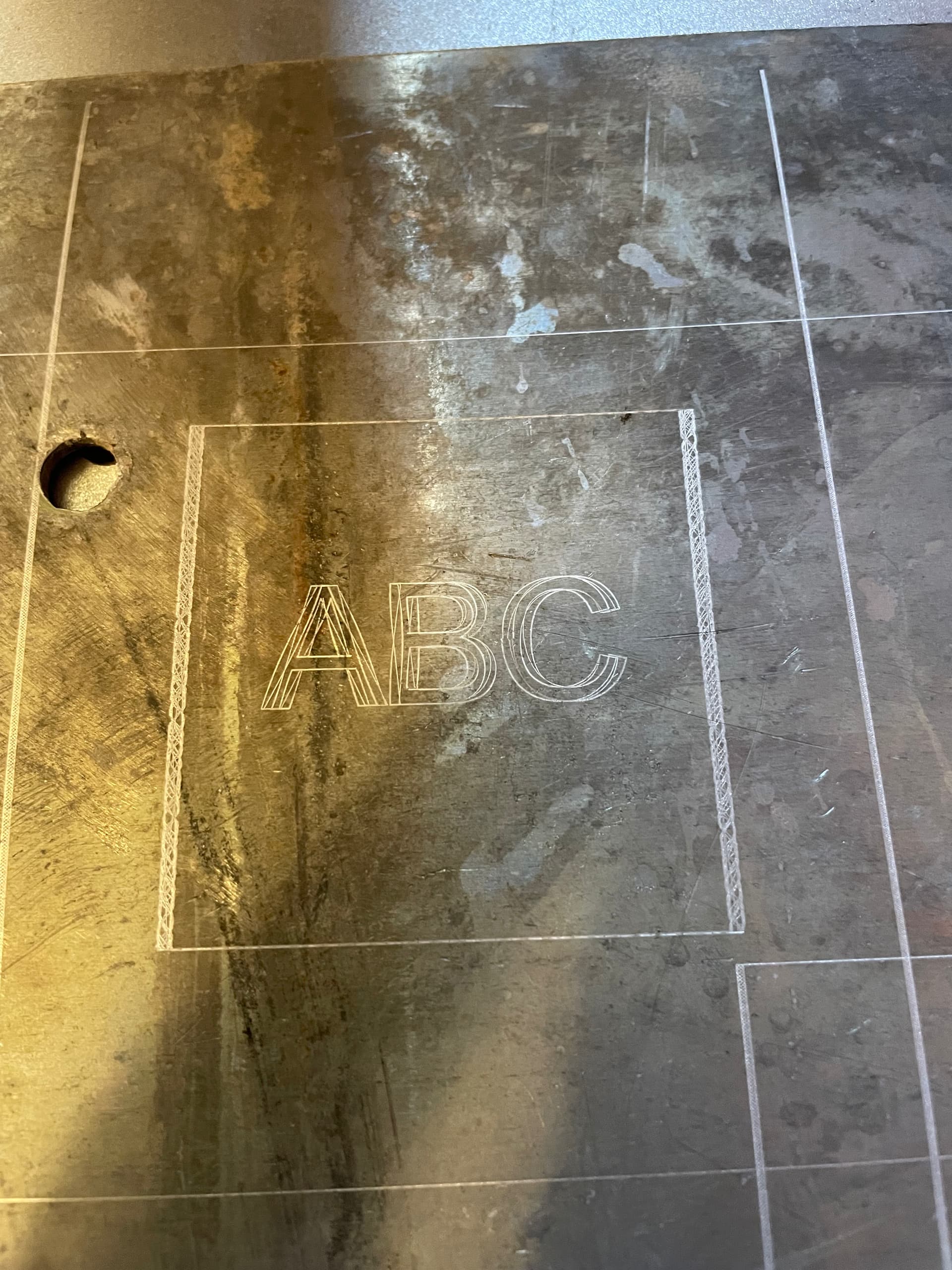

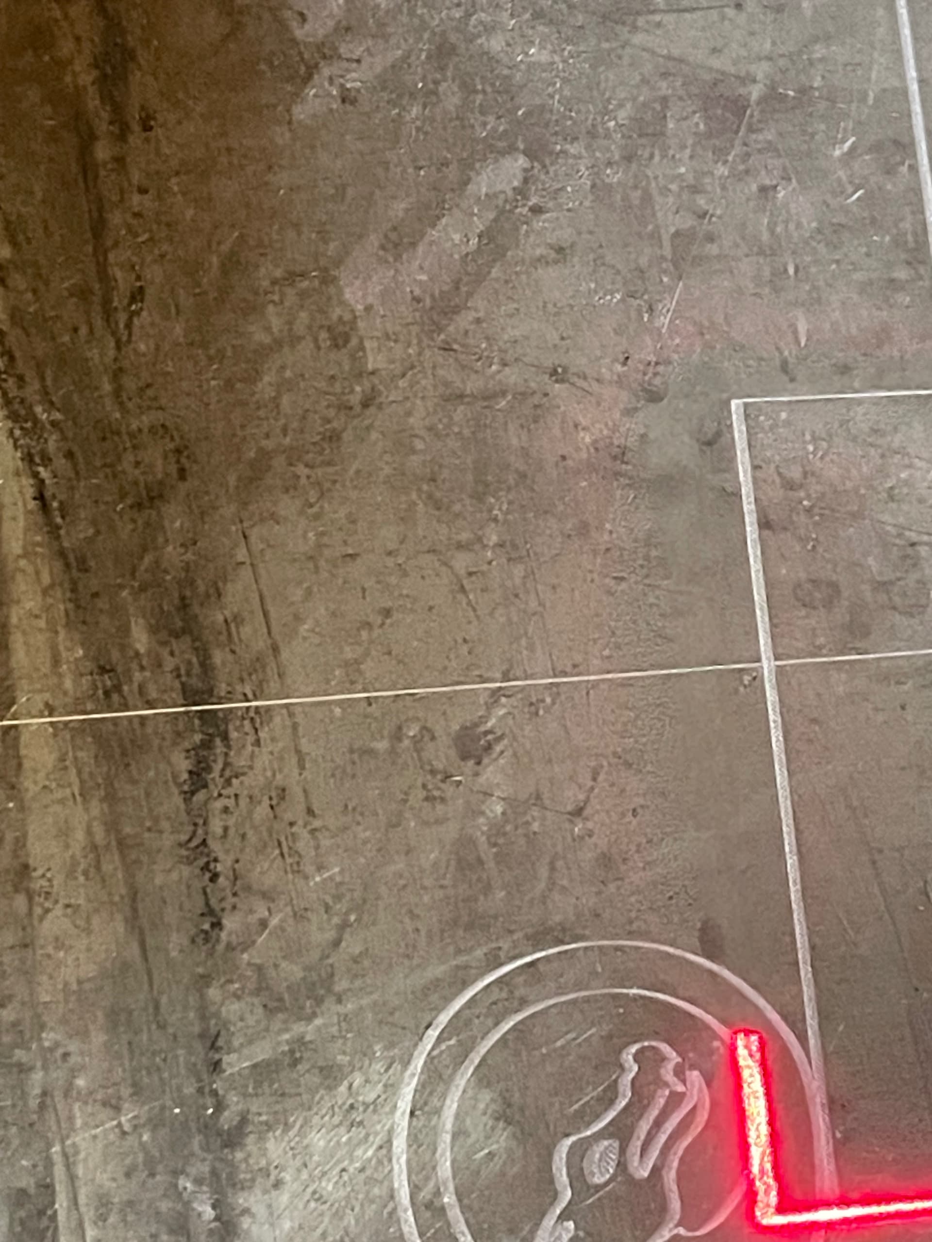

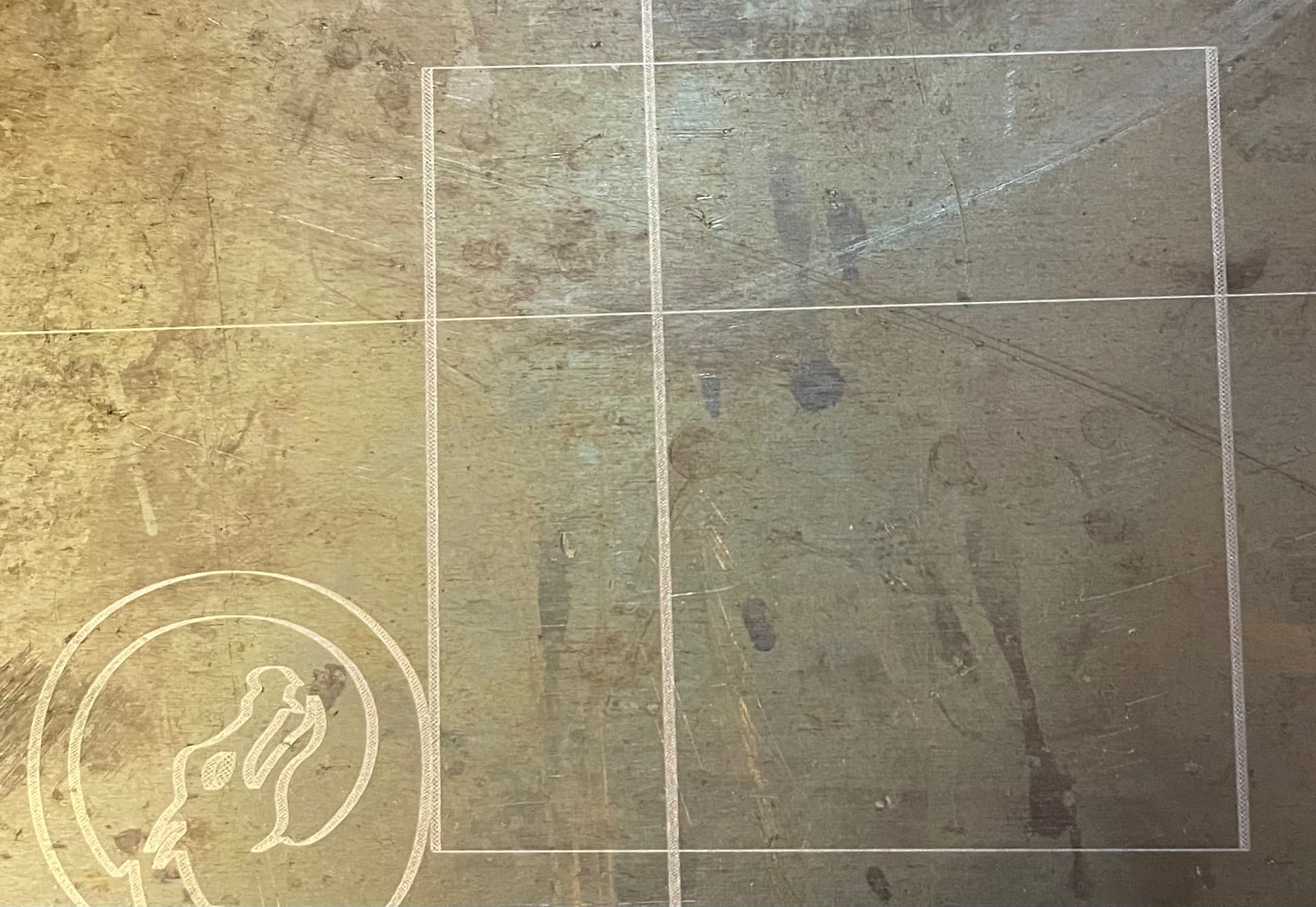

I am getting some weird wide lines on my Y axis on my 30w fiber laser. I have performed the scale adjustments so a 50 x 50 mm square comes out to 50 x 50, and I have performed the 9 point lens calibration. The horizontal lines on the X look good but the Vertical Y are funked up and I don’t know how to fix it. BTW, the company I bought this from a couple years ago, ECPUR, has disappeared, so they are of no help.
Zoom in on the pic and you’ll see what I’m talking about
I dare say it’s a loose screw, and probably on the X-axis motor pulley. Or the X-axis belt is loose.

Also, it appears that it is showing even when framing

I took another picture of the letters ABC done with line setting and 1 pass. I have checked everything I can find but don’t see any setting that would cause this!
I’m not sure what to advise you, I assume it used to work with Lightburn, leaving it as some type of hardware error.
I’ve never seen this with a galvo unless the galvo motors themselves have an issue.
You can see a definite pattern in the vertical lines.

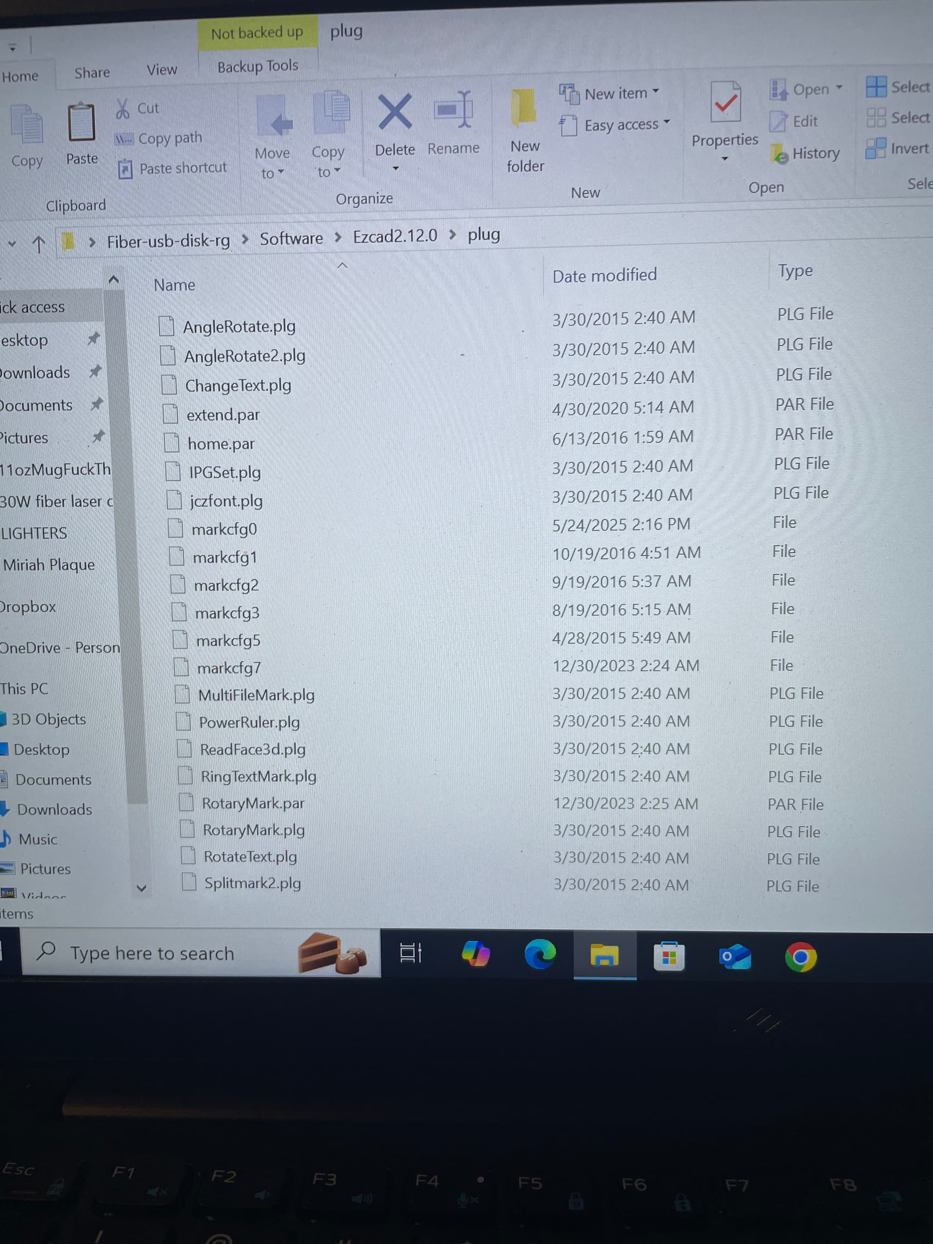

I believe it was ariel font. Just wanted to see what it would do. I think the problem is that I don’t have a markcfg7 file to tell lightburn the correct settings as it worked fine in ezcad. But now after installing it on lightburn I cant go back to ezcad, it keeps saying No Dog Founf
Just click on device and select your device, then edit. It will ask for the EZCad2 configuration file and allow you to navigate to it. Then just click through to finish.
The markcfg7 file lives here on my supplied memory stick.
LMA22A1095JZ/Ezcad2.14.16/plug/markcfg7

It really looks like it could be a bad galvo mirror/servo assembly. Which means replacing the galvo head. The servo/mirror itself could be replaced, not impossible, never tried to source one.

Possibly though the scanning parameters are set for bidirectional and 0 degrees with bad timing settings. Please post file and screenshots of your device settings window “Galvo and Basic Settings” and the “cuts/ layers” window with the parameters you are using.

I have searched for the markcfg7 file and found it but lightburn doesn’t see it so I can’t import anything
Start from scratch, set up a new device and go through the steps, shouldn’t be an issue.
I was able to get the file into lightburn. Still does the same thing. I ended up conversing with a friend in China and they got their engineering involved and I was told it is the motor in the galvo head. I am working on getting a replacement head.
