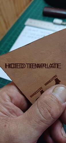

I have a Creality falcon 10w, it started printing double, I tightened the x axis belt but it is only getting worse. Do you have any suggestions for me?
This was the first print
This was the second print after tightning

If you turn off bidirectional scan, and the double goes away, check the set screws on the Xaxis motor coupling.
