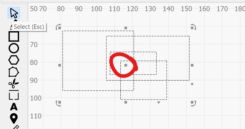

You might need to hit the Escape key to activate the selection tool.
Dragging on this center rectangle should work:

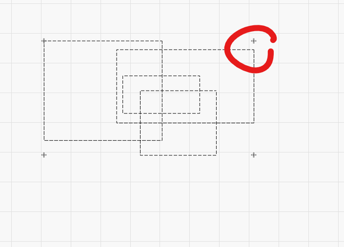

If you don’t see this, your shape might be locked?

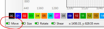

Purely a guess without screen shots, but in the lower left hand corner of the LightBurn window, do you perhaps have the toggle for “Move” turned off?

Thank You Sutick SOOO much…Not sure how the move slider was off, That was the fix.
