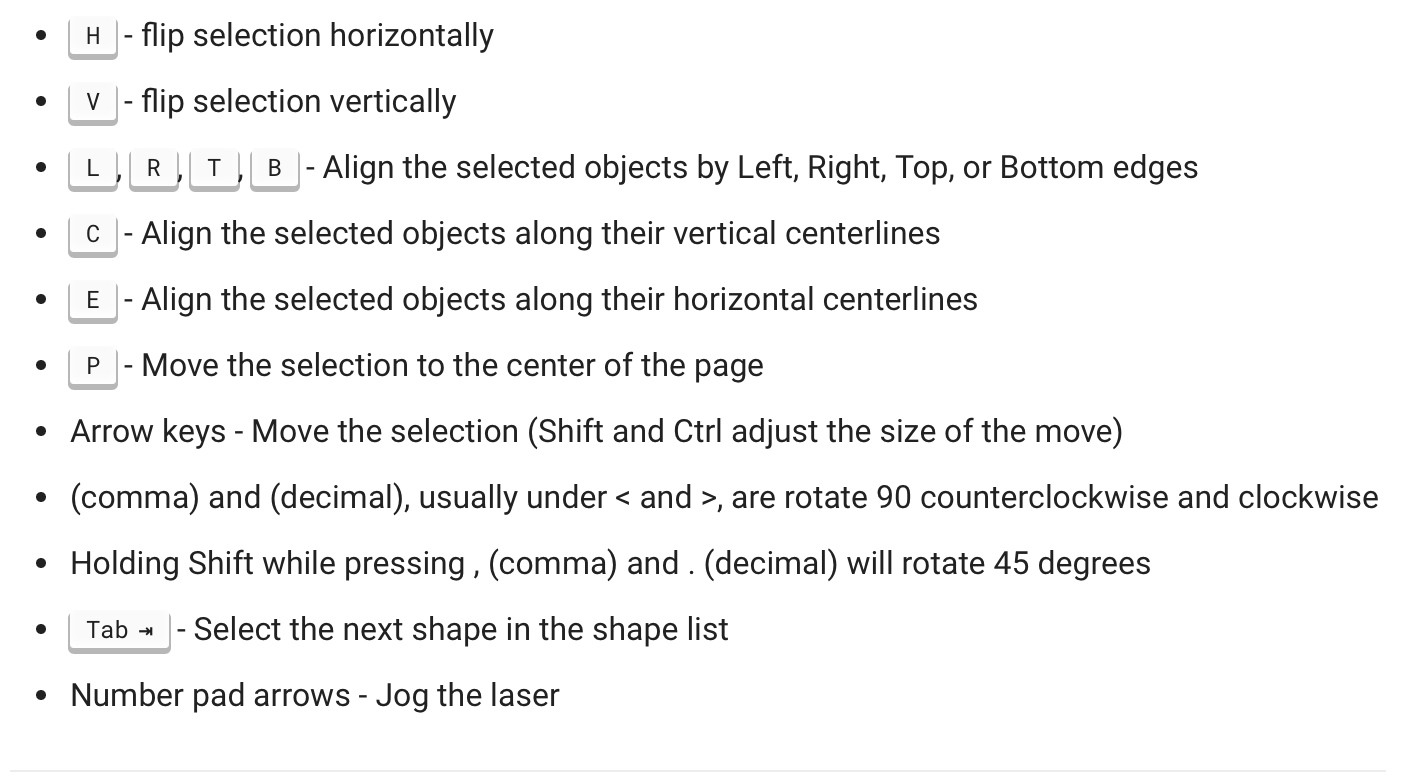

Hätte mal bitte eine frage wenn ich etwas um 45 grad oder 90 grad drehen möchte wie gehe ich sm besten vor . Vielen dank
There are several options. Pressing period or comma rotates your selected square 90 degrees. In the top menu is a degree tool, it can also be used for free rotation of all shapes, and there is also a 45 degree option.
Enter a desired angle value in the “Drehen” field.
