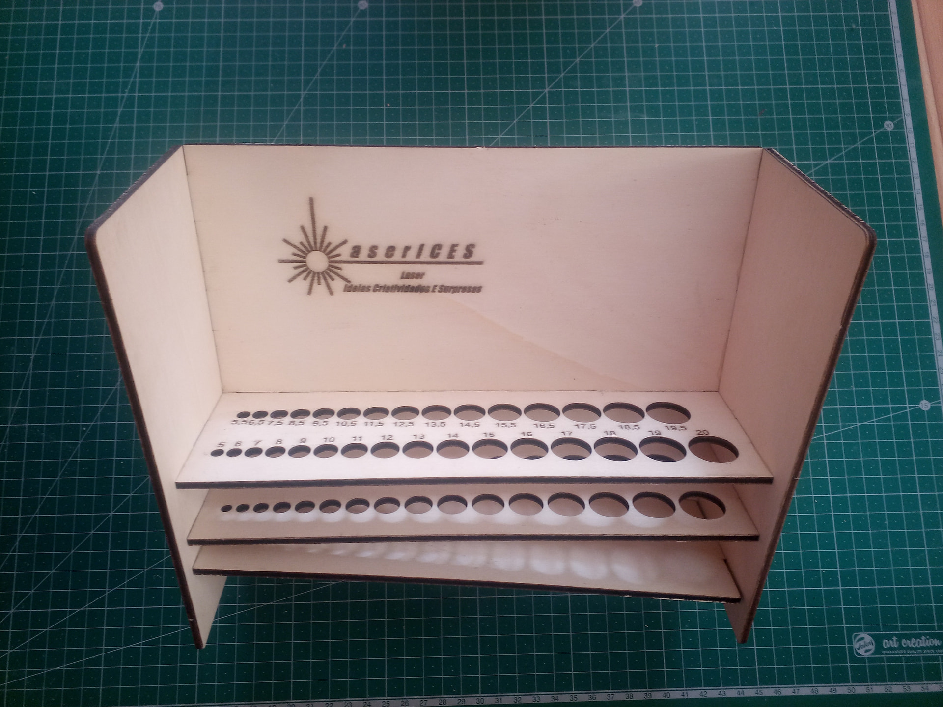

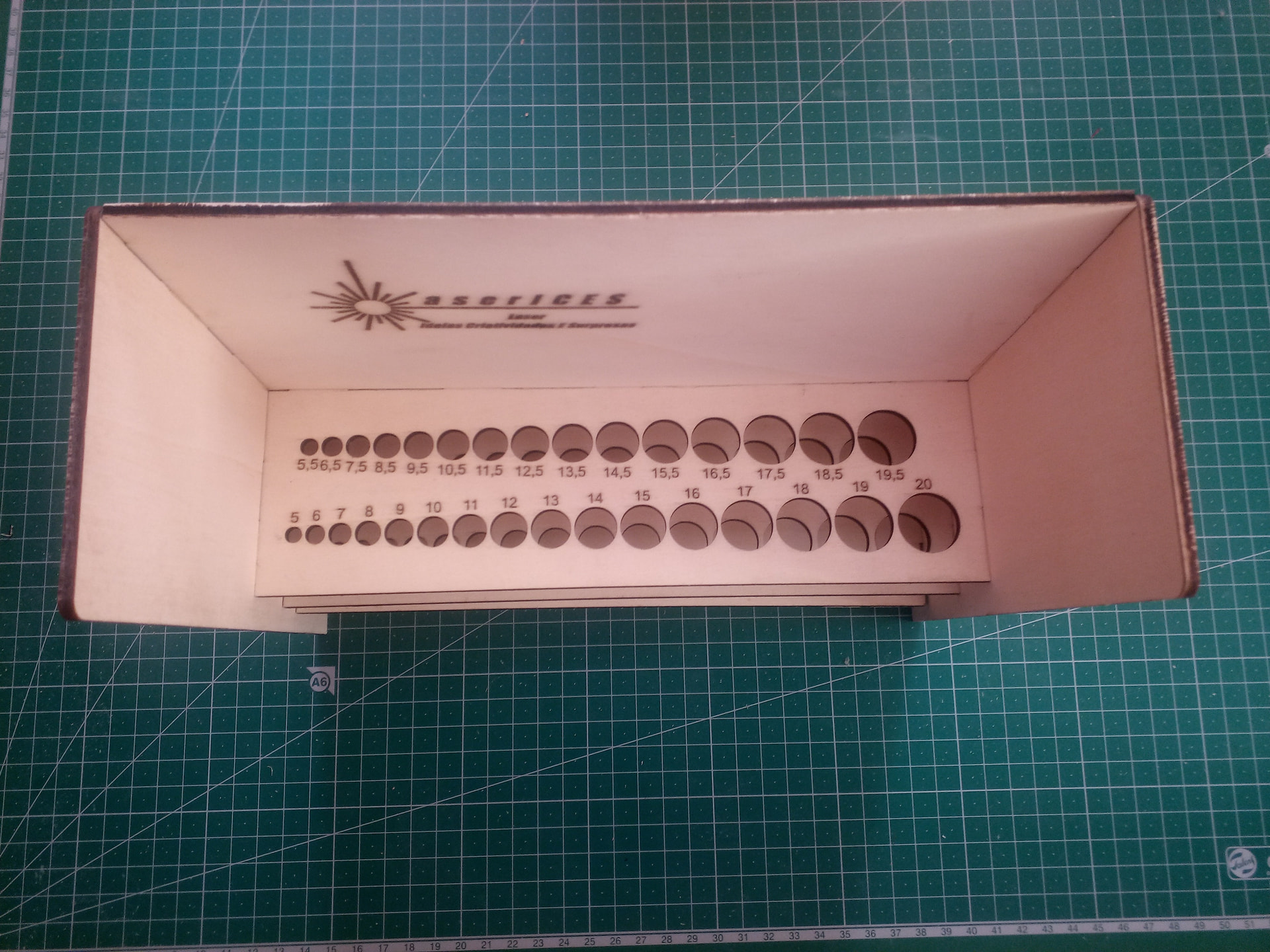

This is an experience of mine that may be useful to someone else.
In this case, it’s a drill bit holder for 5 to 20mm drill bits to be used in a lathe and a milling machine that I have. (that’s why smaller sizes don’t make sense)
Who intends to use the model, should be aware that it is necessary to correct the cutting settings, including the kerf value.
Doing a test hole with kerf is recommended.
[Suporte Brocas 5-20.lbrn2](https://forum.lightburnsoftware.com/uploads/short-url/sI9AZRJHibSgqNg4acfYahw9ACc.lbrn2) (141.2 KB)
 ![IMG_20260503_174541](https://forum.lightburnsoftware.com/uploads/default/original/3X/a/c/acf13328a599c5a7f9b1ad101b96c3ffa99f4c06.jpeg)
 ![IMG_20260503_174348](https://forum.lightburnsoftware.com/uploads/default/original/3X/f/e/fece2b7f5145a8b4ebd093f4fcadb78d6eb1d2a6.jpeg)

Nice work! I appreciate the slanted bottom stop so the drill tips are all approximately the same height.
<div class="post-metadata">
**Author:** ![Kuth](https://forum.lightburnsoftware.com/letter_avatar_proxy/v4/letter/k/bc8723/32.png) [@Kuth](https://forum.lightburnsoftware.com/u/Kuth)\
**Post date:** [May 7, 2026, 7:52am UTC](https://forum.lightburnsoftware.com/t/drill-bit-holder-for-lathe-and-milling-machine/189516/7 "2026-05-07T07:52:01Z")
</div>
Thank you for your comment and attention to detail Colin!
For clarification, the purpose of the base inclination is more to distribute the mass point and not so much to align the top of the drill bits.
Although it does that somewhat as a consequence, in reality the top of the drill bits continues to have an increasing inclination as the drill bit size increases.
To approximate the alignment of the top of the drill bits, I would need an inclination of around 20-25º at least. Which works very well as a display. 😇 (Let me explain) In the real world, drill bits wear out or break, and especially with larger diameter drill bits, unlike smaller diameter ones, it’s not always worth buying new ones, so people sharpen (at least I do this) the larger diameter drill bits.
This results in a reduction in length and, as a consequence, there are always some drill bits that stand out from the others.
The inclination didn’t involve any mathematical calculation, and I don’t even know what angle I used. I simply tilted it to shift some of the weight downwards and prevent the center of mass from being too high, because when inserting or removing a drill bit, it becomes very easy for the entire support to fall if the center of mass is too high.
In short, it almost took me longer to write this comment than to draw the drill holes. 😆

</div>
Nice Work!
I noticed that you are using 16 passes to cut. What thickness ply are you cutting?
I aslo noticed a 17th pass with no power, is that to blow away the soot?
**Post date:** [May 8, 2026, 8:04am UTC](https://forum.lightburnsoftware.com/t/drill-bit-holder-for-lathe-and-milling-machine/189516/9 "2026-05-08T08:04:32Z")
</div>
Thank You!
After many attempts, these were the settings that stood out best for plywood (in this case, I believe it’s linden wood, but I’m not sure).
> [@RonSa](#):
The plywood is only 4mm thick (the standard is 3.8mm, but the quality of materials of this type here leaves much to be desired, and when measured, 3.8mm is only in some areas; most of it is 4mm).
16 passes ensures a clean cut, without large areas completely charred and without smoky effects on the wood face.
In the end, when I run finger across the cut, no charcoal sticks to my finger. If it does, it’s minimal.
The division into sub-layers allows the cut to cool while the laser works on other sections.
The extra time I spend on the passes is definitely worth it if I had to do cleaning, both of the cuts and the smoky effects on the wood face.
> [@RonSa](#):
Exactly. Incredibly, without that step, when I ran my finger over it after completing the cut, charcoal from the last pass would stick to my finger.
As I mentioned, these settings are for my laser machine (for my specific case). The settings will be different on a different machine or with a different material.
I appreciate your curiosity! 👍
