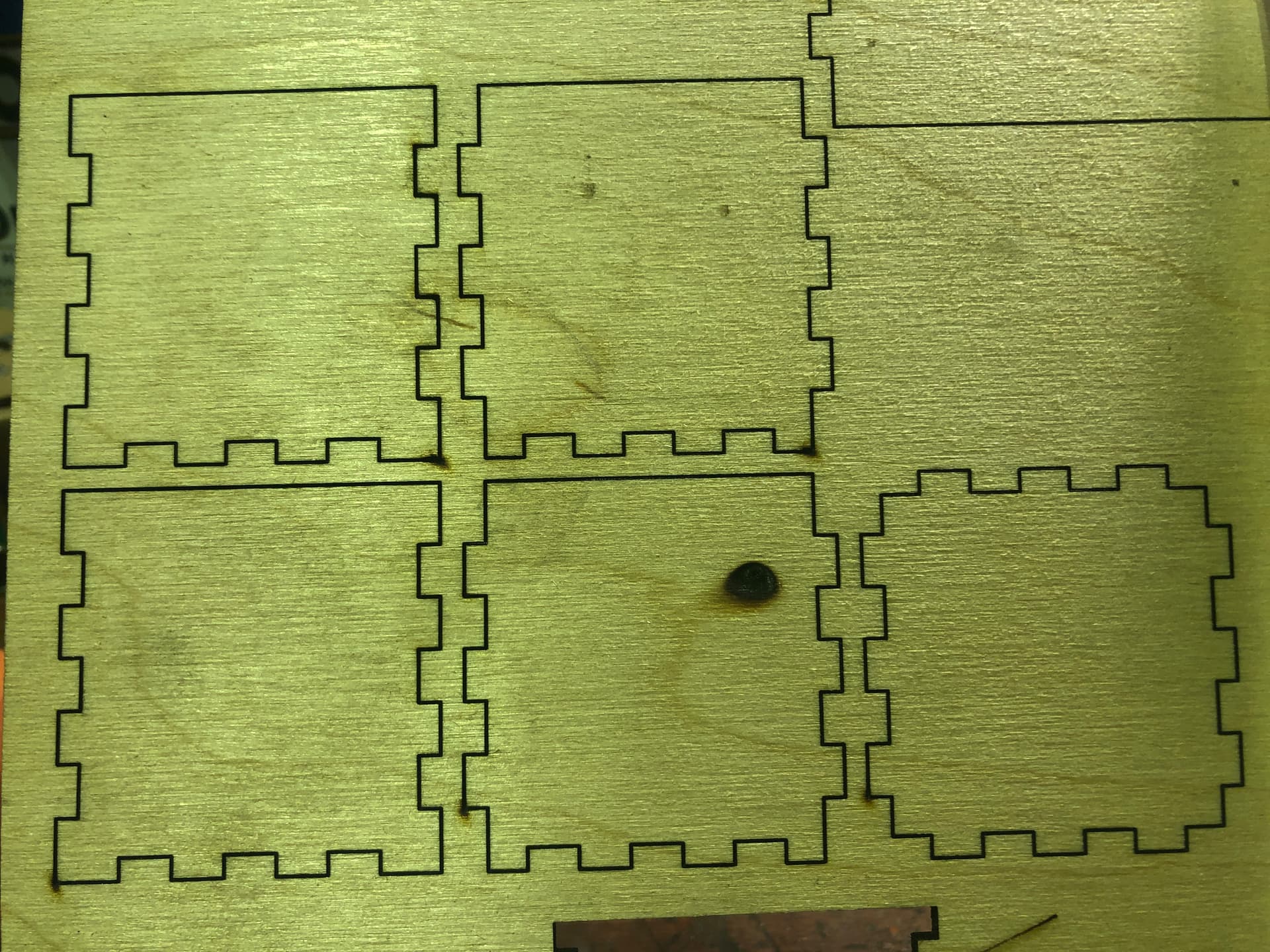

.DXF file getting distorted

As I was doing more testing last night I did a last minute check and found the two set screws on my Y axis drive pulley, they were loose. I put thread lock on them and tested it again this morning and it came out perfect.
As an electronics technician they say always look for the simple stuff first. I totally missed it, my bad. Thank you everyone for your input and help I do really appreciate it.
