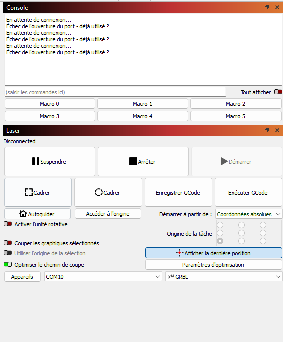

J’ai un petit souci. Impossible de me connecter avec le laser SCULPFUN . Échec de l’ouverture du port - déjà utilisé.
Jusqu’à hier ça marchait bien ,j’ai désinstaller le logiciel LIGHTBURN et réinstaller même probleme

Are you getting any unexpected messages or garbled data in the Console window in LightBurn?
It 's often helpful to capture what you’re seeing there. You can do this with a Screenshot…
… or you can select and copy text from the Console window in LightBurn and paste it into a reply here.

Quand je lance la recherche du laser, le programme lightburn ne le trouve pas.
This indicates Windows is not aware the laser is connected. There is a GRBL device on COM10. What is that device?

I still see COM10 in the Devices list in the Laser window. That means something is still connected. If your laser is wanting to use the COM10 connection, that may cause the “busy?” message.
Did you do this? There should only be showing (Choose) in that window.

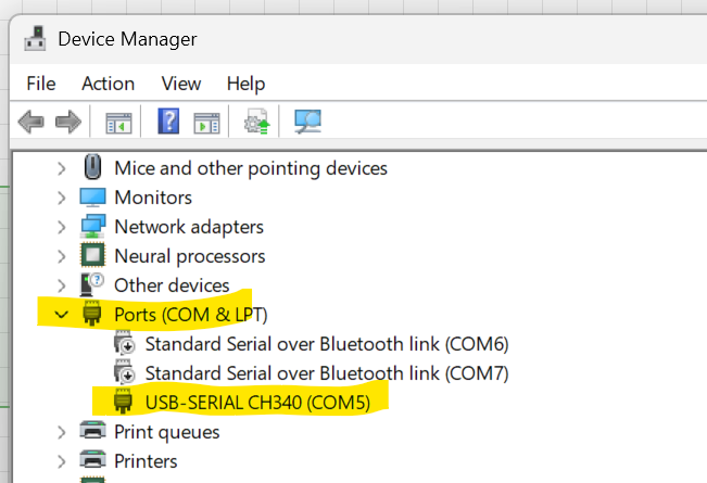

We may have to go into Windows Computer Management to see what is happening there.

If only the laser is plugged in, then unplug it and see if that COM10 in Lightburn goes away.
Are you using the correct power adaptor? There should be a (green) indication light when it’s plugged in. :
The laser should show up in the Ports tab in the Windows Device Manager like this and disappear, when you unplug it:
le laser n’ apparaît pas
the laser does not appear
