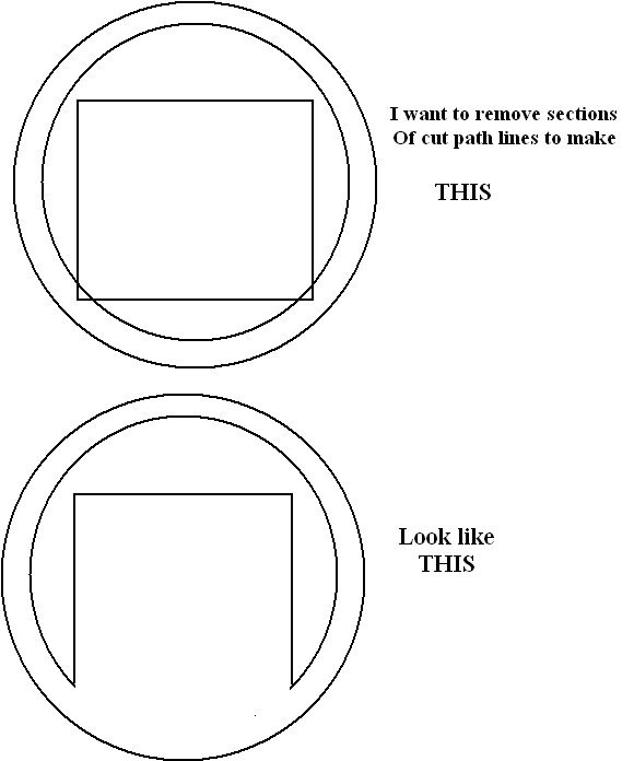

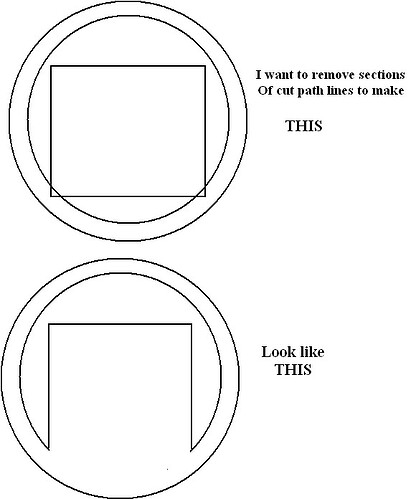

I would like to delete only a part of a cut path,
  1. Select inner circle
  2. Add square to selection
  3. Tools->Boolean subtraction
  4. Ungroup resulting shape
  5. Delete extraneous shape at bottom
Thank you, berainlb, very much. I probably should have thought of that myself. It worked perfectly.
