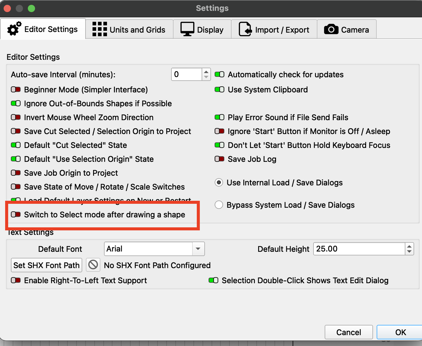

Perhaps this option isn’t set the way you expect:

By default, Lightburn maintains the drawing tool you were using. This makes for faster repeat drawing and there is a switch to change this behavior if desired. It is in Settings (Gears Icon).
You need to choose the select tool to move an object. In other words, escape key deselects the square, then you click the select tool and click on your square. Now it is in edit mode.

Very much sounds like you had duplicated the object.
That or when you drew your first you then went to select it by dragging but LB was in “keep creating objects mode” and the new rectangle you created by dragging was snapped to the original object.
That would look exactly like selecting the first object.
