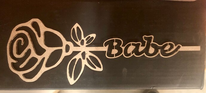

Yes sir, the file sent is the file I edited and is consistently shutting off the laser module in certain spots. By edited, I mean I moved or added lines to the graphic, edited nodes by deleting, adding or moving them, to create a different path. The original file did not have the word “babe”.
Ist edit, add that to the stem
2nd edit, add the vertical lines in the “B”, “a” and “e”
3rd edit, made the vertical lines thicker.
After the 3rd edit, the symptoms appeared. I will run a test and upload the issue

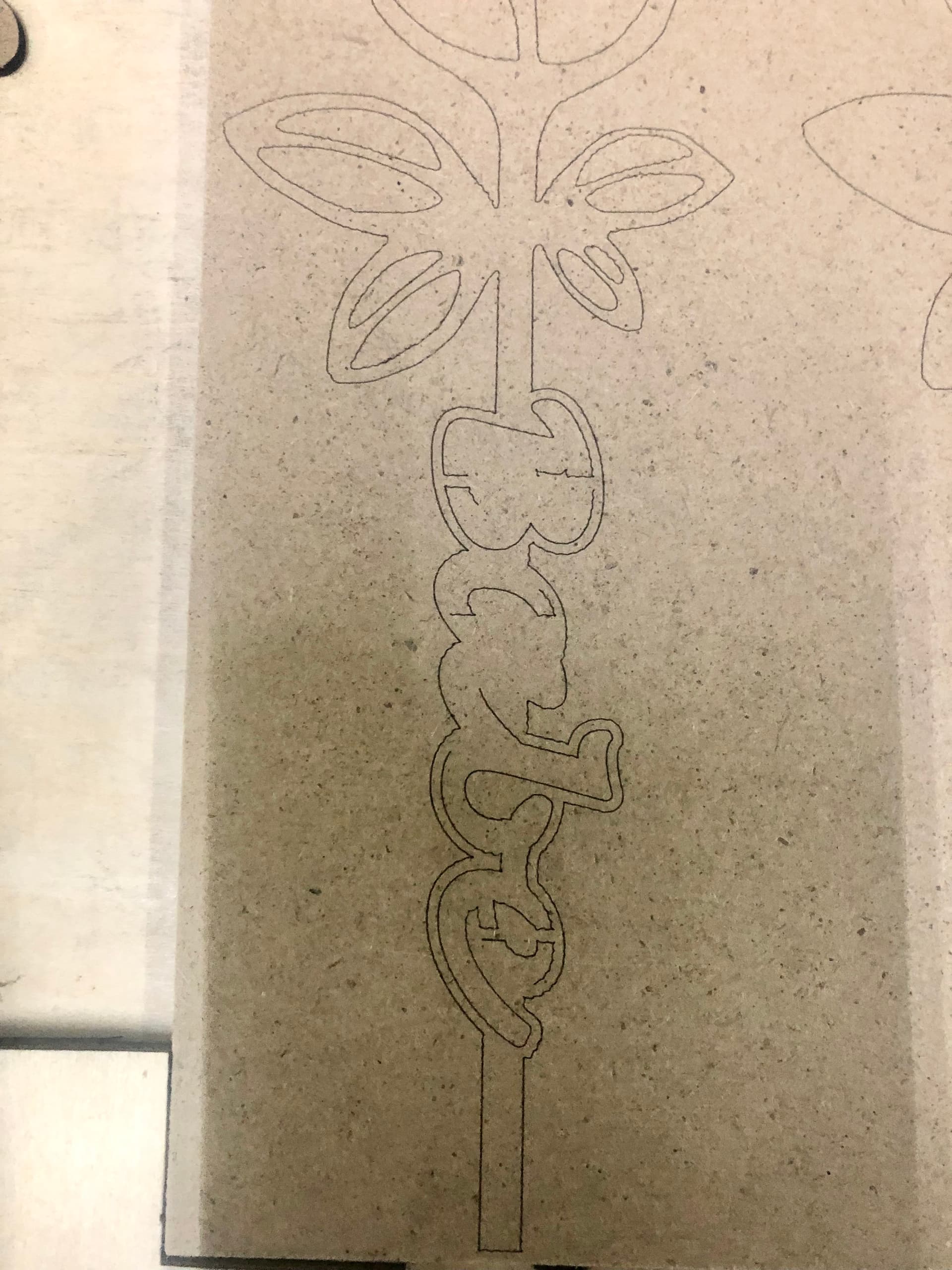

As you can see, the laser module just shuts off as if those areas in the word “Babe” are blank.

I’m noticing one thing. You have Constant Power Mode enabled. What firmware revision are you on? I recall there was a firmware bug where Constant Power Mode on some Ortur models was causing dropouts during deceleration.
The way you’ve constructed some of the edits looks like they’d have some odd acceleration/deceleration points. I suspect what’s happening is that due to those added areas with extreme acceleration/deceleration the firmware bug is presenting.
Try disabling Constant Power Mode and trying again.
And again, can you confirm your exact laser model and firmware revision?
Good lawd, I turned Constant Power Mode off and it worked…
