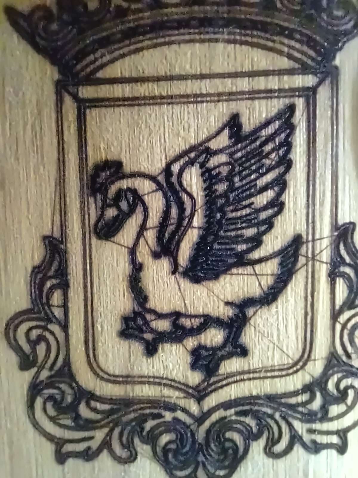

sorry forgot pic with example of laser not turning off, should be obvious where
(yes speed and power need adjustment too)

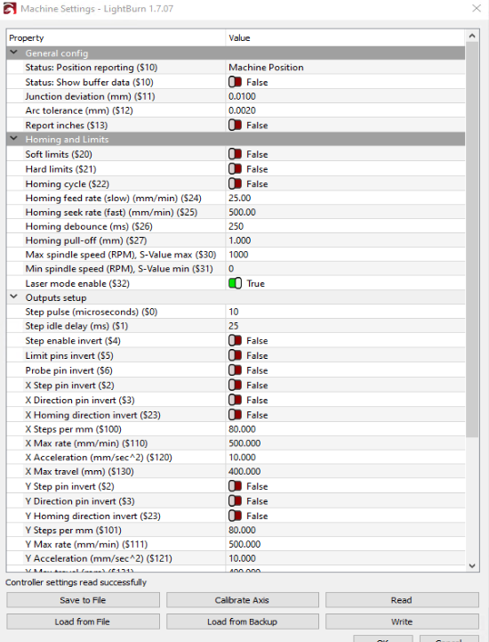

32=1 and the laser doesn’t turn on at all
32=0 turns back on, but still stays on between objects

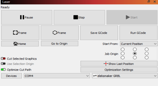

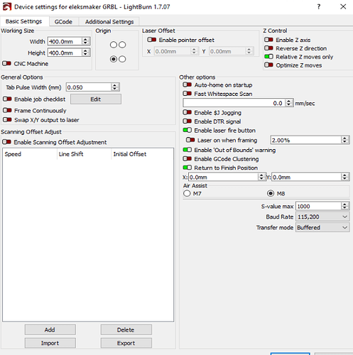

Which dialect of GRBL did you select when setting up the Devices window? Screen shot your laser window and upload it.
laser window?
this?

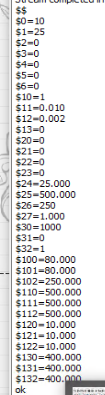

console on connection
device settings
machine settings
Yes. I see “eleksmaker GRBL”. Did you have to import a .LBDEV file to get it working? Those control the operating characteristics of the laser. None of my lasers use those, so I have no idea how to fix one if that is the problem.

nope, lightburn picked that for me, all I did was select the serial port, lightburn detected the rest

$32=0 Laser stays on during traverse moves.
$32=1 Laser does not come on at all.
—Can you enter $$ in the Console window and double check you did not enter 10?
Maybe try entering 3, 4, or 5 to see what happens. This is definately a unique problem!
yeah, I had verified it

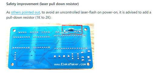

If you´re using a EleksMaker board did you made this change?
