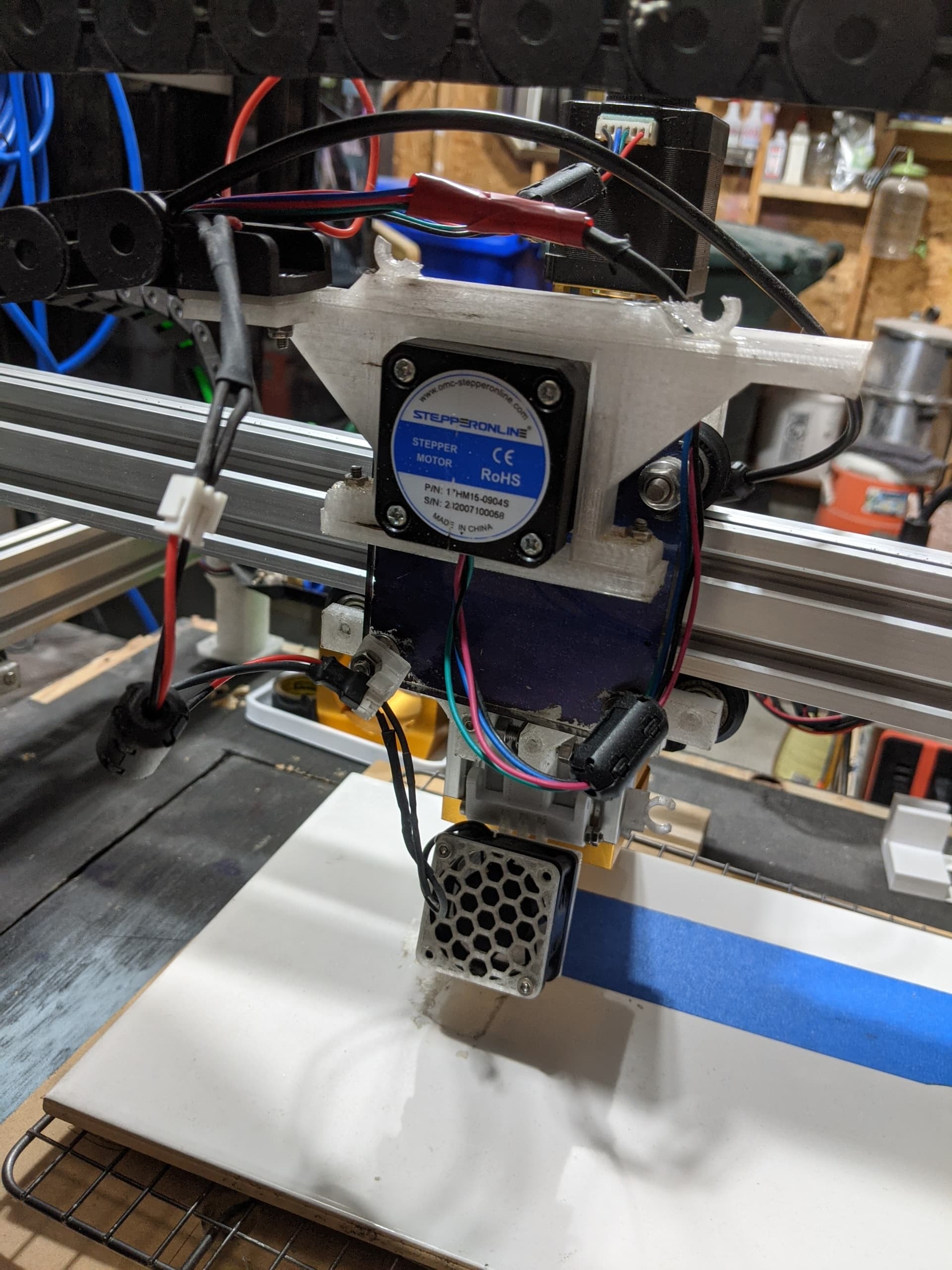

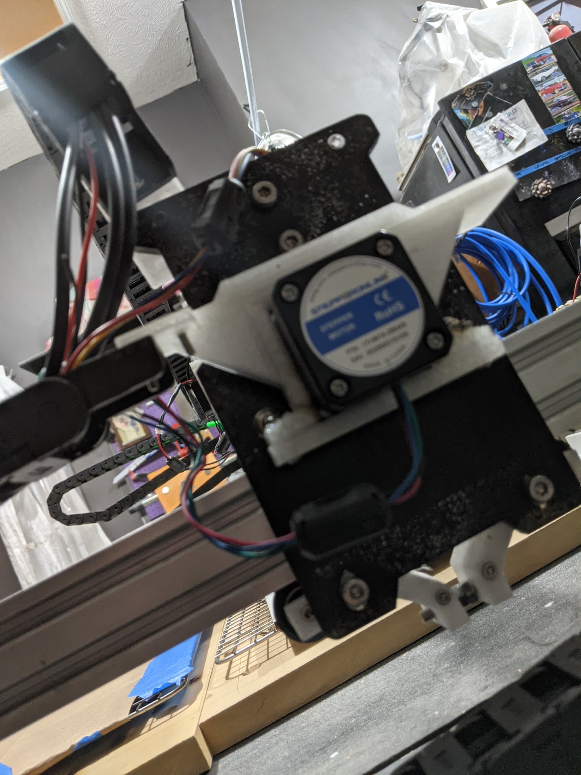

Photos of the board and steppers

I found the problem… smh
That little container drop that I mentioned… Definitely unseated the Nano. At the angle of my normal point of view, I didn’t even notice until I actually got to eye level. Was going to swap it out and bingo bango…
Hardware problem after all.
