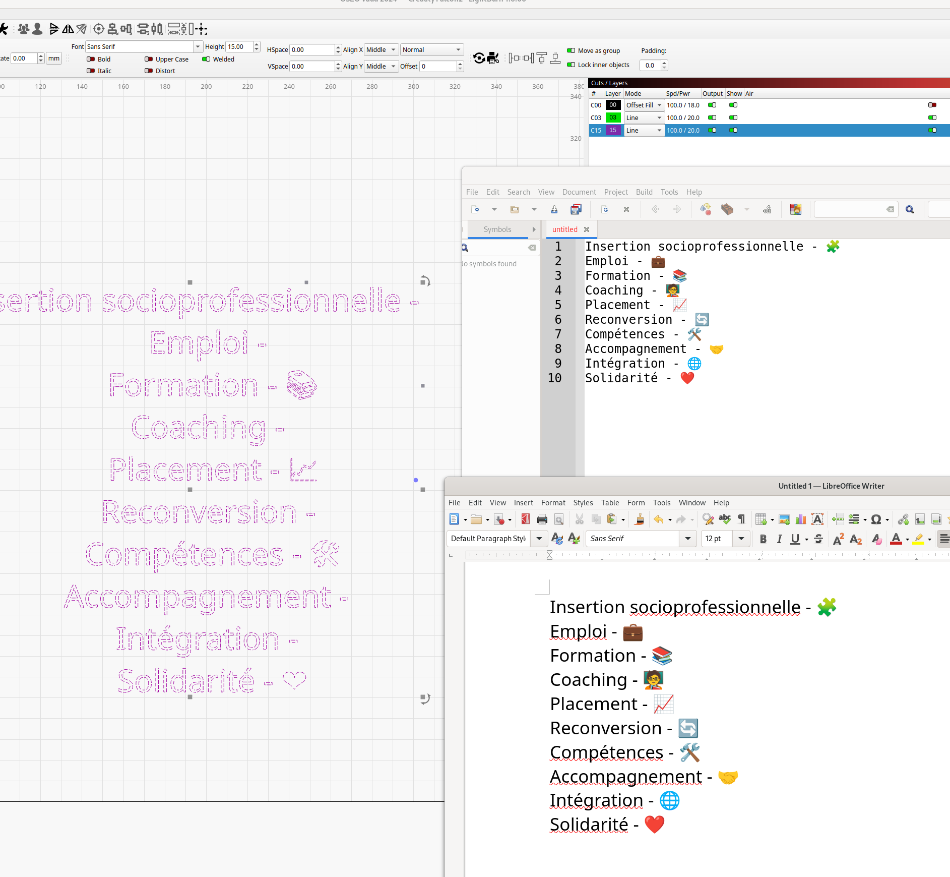

Many emoji are not well supported on Ubuntu 24.04
I tried all fonts.
They are working great with the same font in other applications!
I have the following list of keywords
Insertion socioprofessionnelle - 🧩
Emploi - 💼
Formation - 📚
Coaching - 🧑‍🏫
Placement - 📈
Reconversion - 🔄
Compétences - 🛠
Accompagnement - 🤝
Intégration - 🌐
Solidarité - ❤
How it’s displayed in LightBurn 1.6.00.
Emploi -
Formation - 📚
Coaching -
Placement - 📈
Reconversion -
Compétences - 🛠
Accompagnement -
Intégration -
Solidarité - ❤
 ![Screenshot from 2024-06-07 08-45-17](https://forum.lightburnsoftware.com/uploads/default/original/3X/0/a/0ae0830825bddd53560ab5365a05b7f2a10ab7fb.png)

Emoji are currently not supported by LightBurn.
Neat that you have some of them working though!
Potentially a work around to get the rest would be downloading the SVGs from the [tweemoji project](https://github.com/twitter/twemoji/tree/master/assets/svg) and importing them into LightBurn, and perhaps then adding them to an [Art Library](https://docs.lightburnsoftware.com/UI/ArtLibrary.html) for easy reference.

The emoji are so cool in lightburn, I hope you will officially support them soon!
I try to understand what make them different.
(Based on chatgpt)
Non-Working Set: 🧩💼🧑‍🏫🔄🤝🌐
    🧩: U+1F9E9 (Emoji 11.0, 2018)
    💼: U+1F4BC (Unicode 6.0, 2010)
    🧑‍🏫: U+1F9D1 U+200D U+1F3EB (Emoji 12.1, 2019)
    🔄: U+1F504 (Unicode 6.0, 2010)
    🤝: U+1F91D (Unicode 9.0, 2016)
    🌐: U+1F310 (Unicode 6.0, 2010)
Working Set: 📚📈🛠️❤️
    📚: U+1F4DA (Unicode 6.0, 2010)
    📈: U+1F4C8 (Unicode 6.0, 2010)
    🛠️: U+1F6E0 U+FE0F (Unicode 7.0, 2014)
    ❤️: U+2764 U+FE0F (Unicode 1.1, 1993)
Could be related to ZWJ sequences or unicode version.
When I use code point, UTF-8, UTF-16, UTF-32, they look really similar. As an example:
Not working: 🌐 U+1F310 - F0 9F 8C 90 - D83C DF10 - 0001F310
Working: 📚 U+1F4DA - F0 9F 93 9A - D83D DCDA - 0001F4DA
