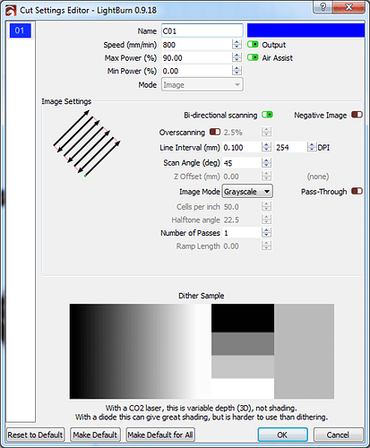

When I import an image such as a greyscale bitmap PNG, I assign it a cut (colour?) number C01, then setup C01 with speed, power, and dithering options; but when I generate GCode all I get is

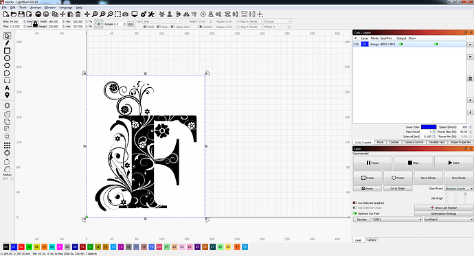

This is my main screen
and this is the cut configuration
(I have tried other image modes).

Move the file slightly off the side of the workspace. Most likely the image is being removed because it is crossing the page boundary.
OH! I am getting a warning to that effect by I understood it to mean that the image would be cropped/truncated, not completely omitted.
THANK YOU!

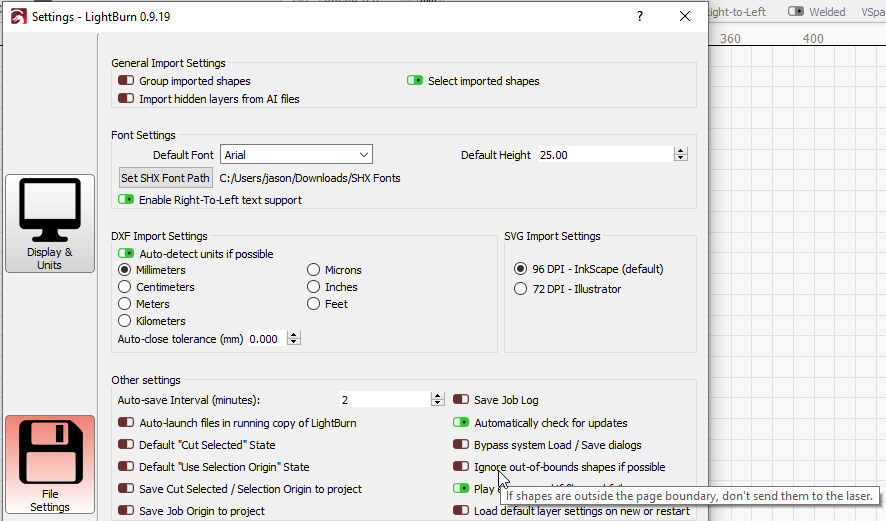

We don’t crop or truncate, but there’s a setting (on by default) to discard shapes that are out of bounds because they would normally crash the machine. If you’re certain that won’t happen you can disable the setting here, in Settings > File Settings:
I see. Yes my machine is more than 2m x 1m, so I never print at its origin. Thanks!
You’re possibly better off using ‘Current Position’ then, as the GCode it emits will be entirely relative moves. Read here: https://lightburnsoftware.github.io/NewDocs/CoordinatesOrigin.html
