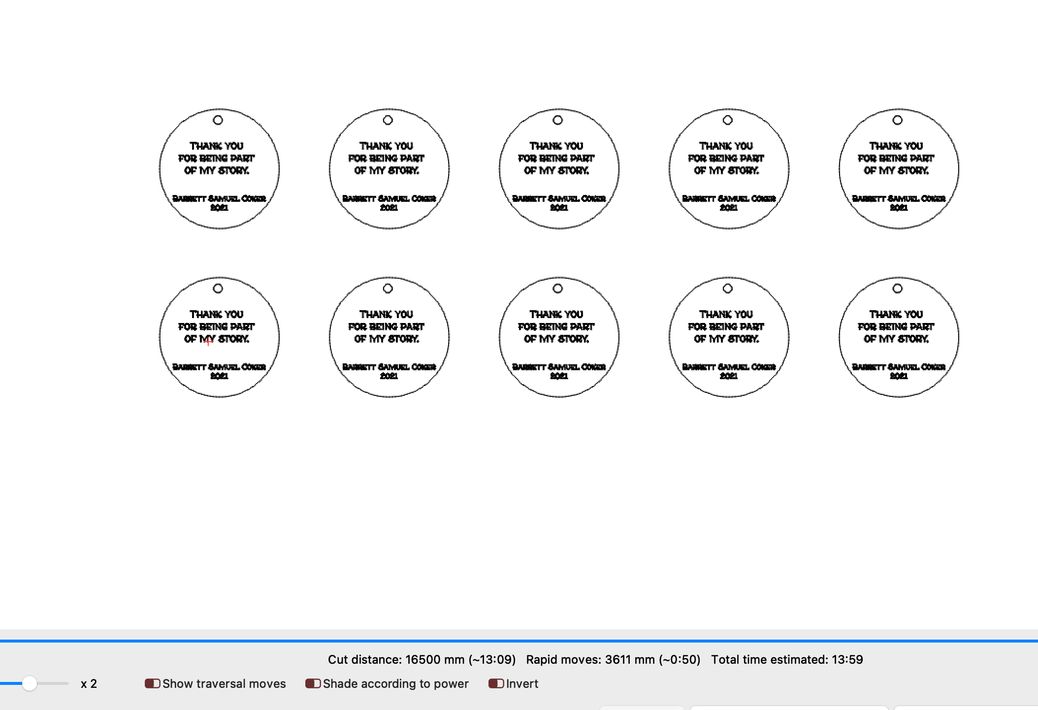

I’ve restarted my computer and now there’s only a single file causing this to happen. It’s a series of 10 grouped offset fills that previews fine when I remove all but one of the groups.
Seems like it’s too much for Lightburn to process? It does this even if I just have two of the groups instead of 1 - which is strange since I’ve run many other far more complex offset fill files before.

I just tested your file on my system which is almost identical (my Mac PowerBook is a bit older) without any problems. Preview comes immediately without any delay.
However, it should be noted that I do not have your original font installed on my machine and use my default font instead.
I ran your file under Windows 10 and it worked properly in the preview.

I restarted my computer (several more times, as I’d already done this), and the problem remained. I was only ever able to engrave the original group that I’d duplicated the others based on. Once I started trying to run the others (even one at a time) it would cause the program to happen.
I ended up having to switch to fill + line to get through this paid order. Still not sure what the real problem is.
