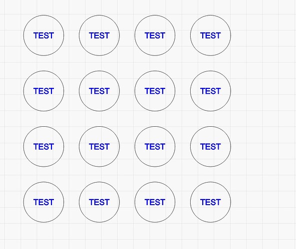

When linear patterning a part with multiply layers is it possible to make Lightburn engrave and cut out part before moving to the next part?
Hi Guys

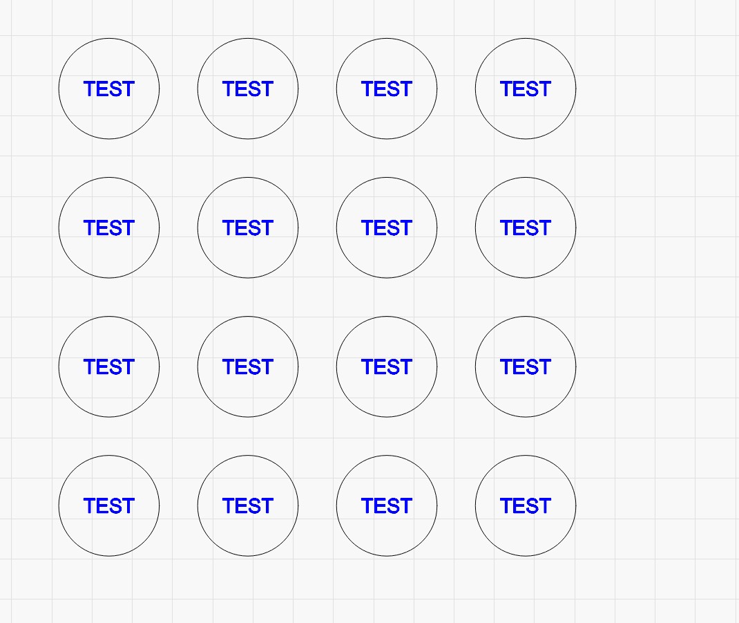

Is there a setting where I can make it engrave then cut one circle one at a time? Like on the attached screenshot.
Group each item individually, (circle & text) before creating your array. Make sure group results is deselected in array dialog. In Optimization settings make order by group the first item, like this.
