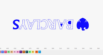

I am trying to import the “Barclays” logo into Lightburn but I cannot set it to fill. I have worked with 100s of logos and never had this issues. I have tried multiple versions of the logo files from various websites and still having the same issue. When I set it to fill it is filling inside the “B” for example.
Does anyone know how to fix this?

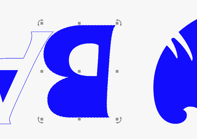

I’m on 1.0.06 too here’s what I see:
If I ungroup then select the ‘B’ outline and perform a ‘Close Path’ on it it apparently doesn’t do anything, however if I then drag the outline a bit it suddenly shows as filled.
If I then ‘Undo’ the drag it remains filled.

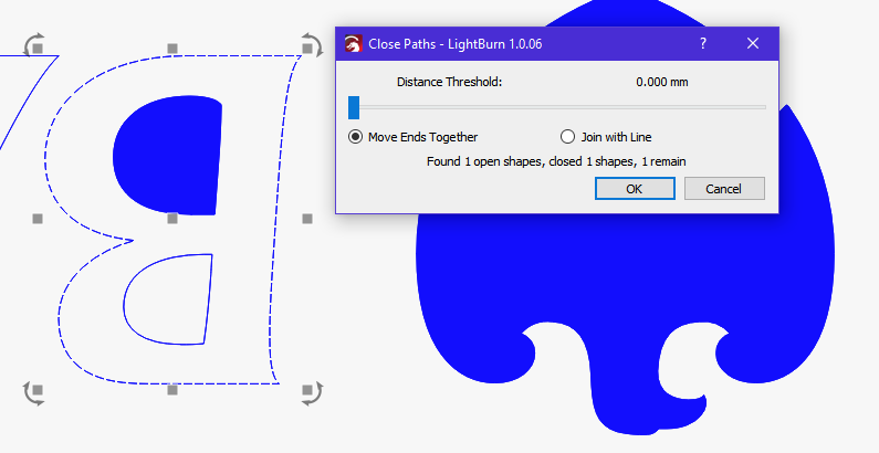

If I do a ‘Close selected paths with tolerance’ I get this:
