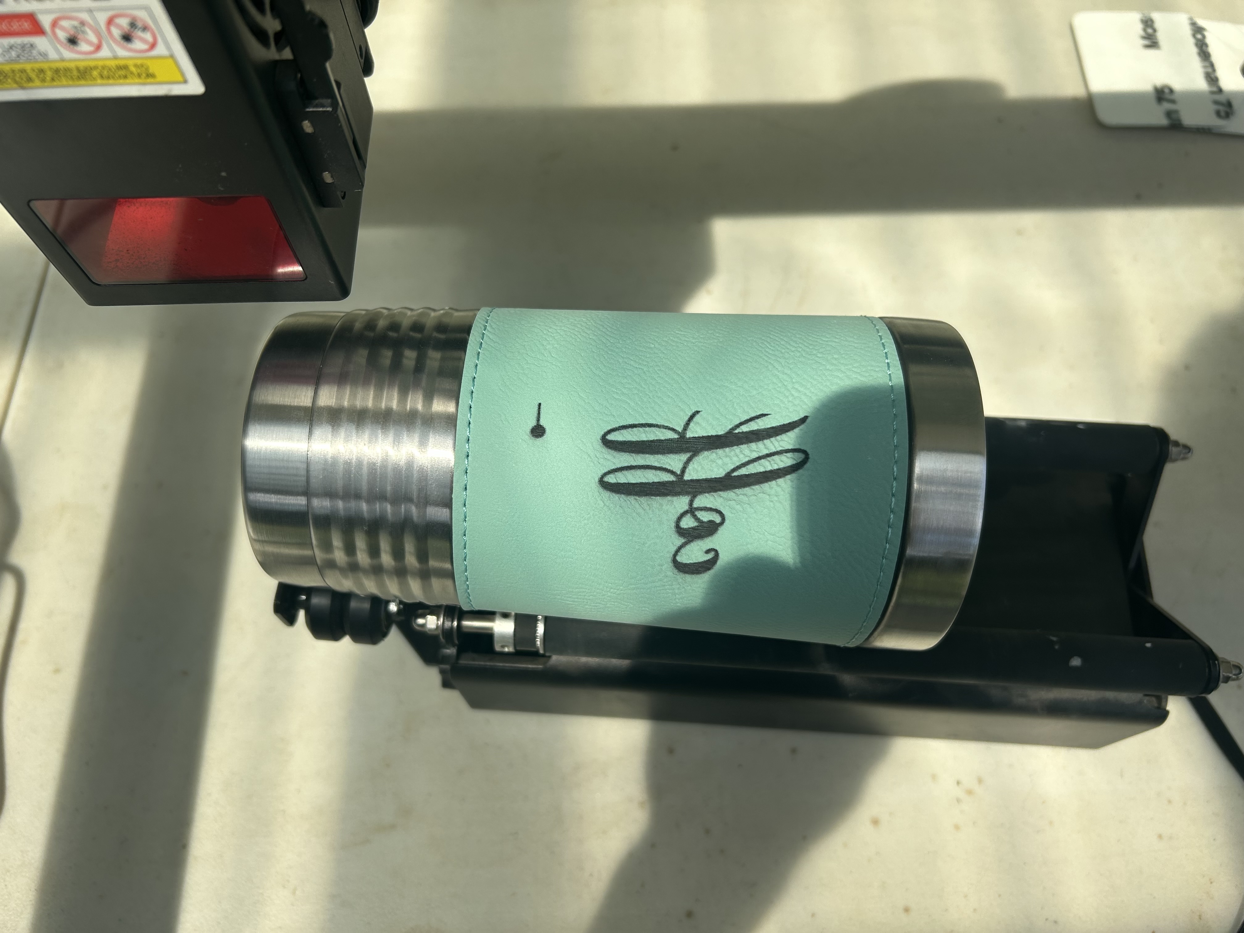

My laser engraver is engraving images inverted. Not sure why any help would be appreciated. I have used this exact setup before and now it not working. I tried a test square and it engraved it counter clockwise when in the preview it shows it going clockwise

I will try that but it does the same thing on flat surfaces as well

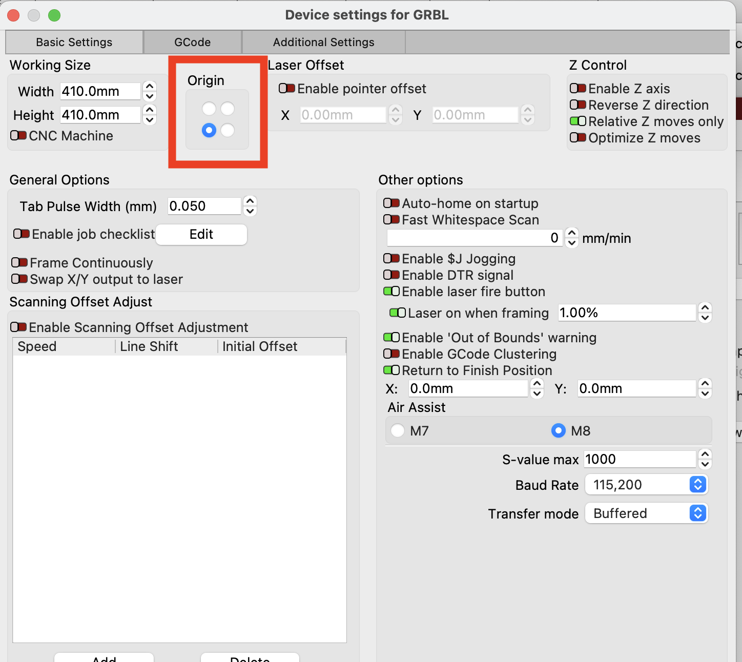

OHHHH, you didn’t say that. You probably have your machine origin set incorrectlly. Most diode lasers have the origin set to front left. If yours isn’t there, change it. Device settings (wrench & screwdriver icon)

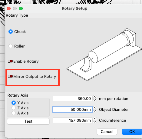

I think having the rotary turned the wrong way (rotated 180) will do it too.
That’s not the issue as even when the rotary is disconnected it will go backwards
That ended up being the problem thanks!!!
