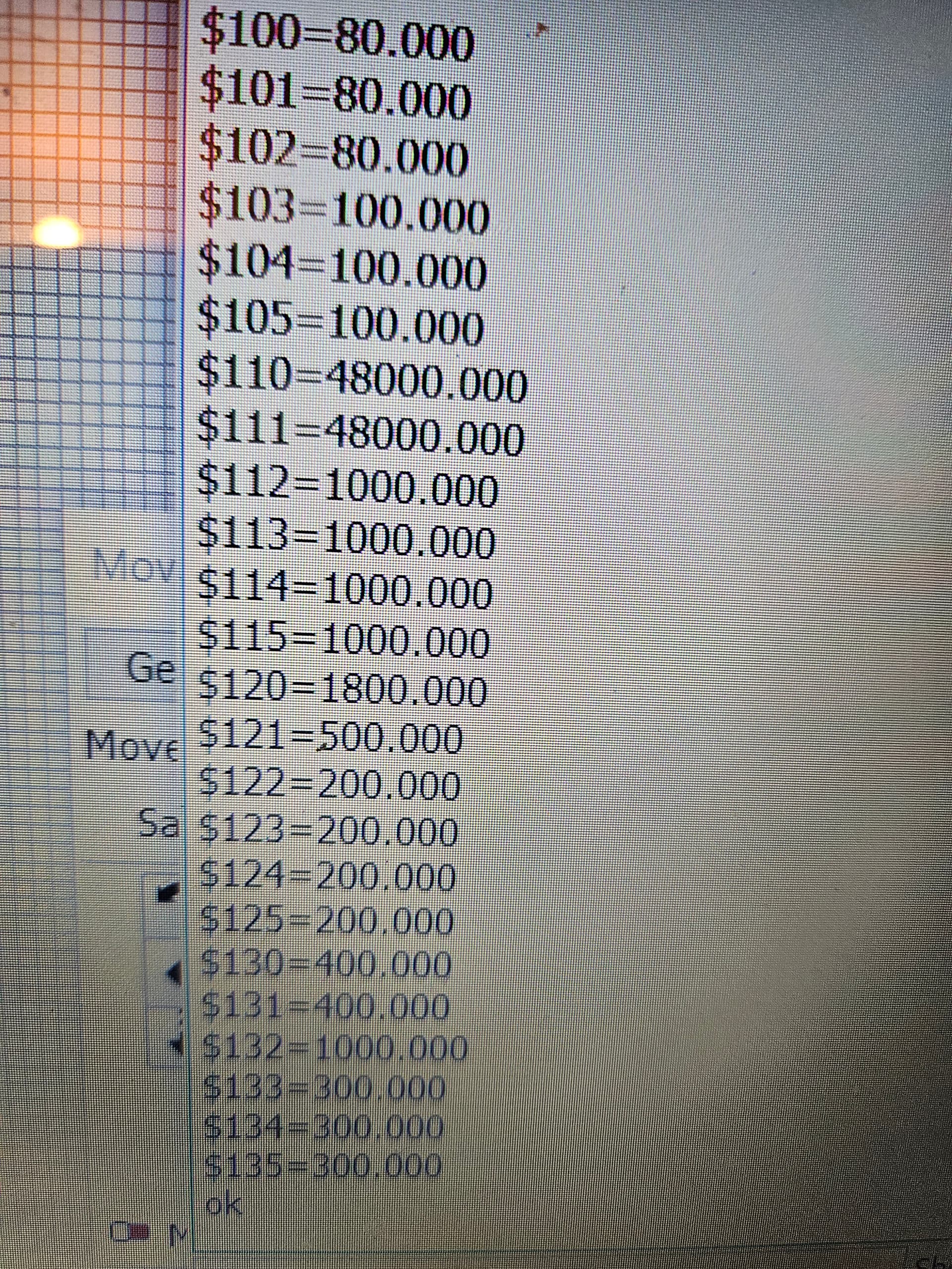

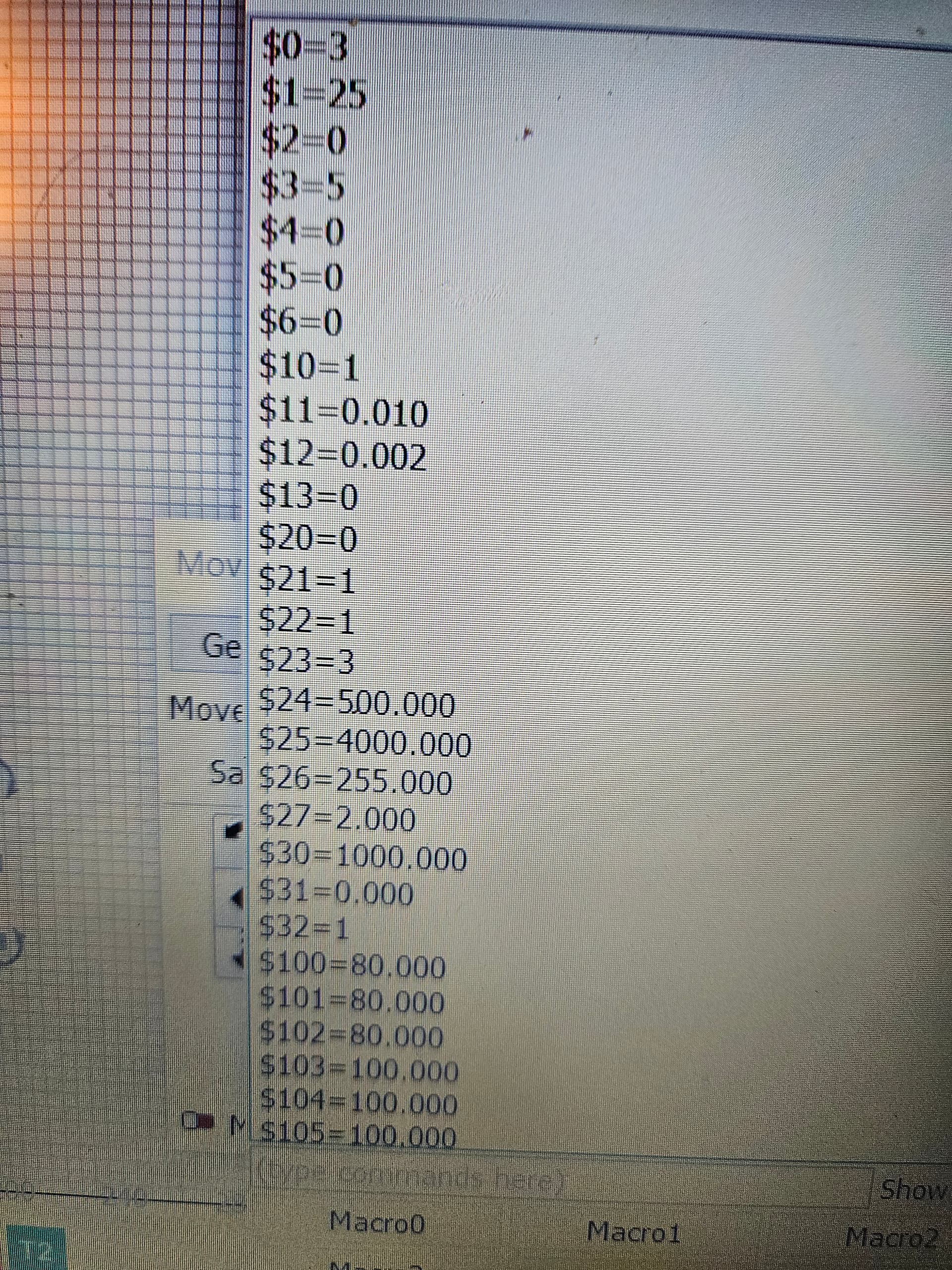

I recently started a free 30 day trial of lightburn version 17.0.07 . I have a Wainlux L8 20 watt laser with a GRBL controller. I have a problem with the width and height setting. If I want a 90 mm circle I enter 90 mm in the width field but I have to enter 41 mm in the height field (just an estimate to get close to a circle) if I enter 90 in both fields, the width engraves correctly but it comes out around twice as high as it should be.
In your console window type $$ then press enter key. Copy and paste all the output here and we will help you.

I couldn’t figure out how to copy and paste it so I took pictures. Thanks again for your help
Your settings look right for a belt drive on X and Y axis which was hard to see trying to look at your machine online.

Your settings look correct. Do you possibly have the rotary enabled?
Yes, I do but I couldn’t get the rotary tool to turn.
That’s most likely why your Y axis is off. The rotary overrides the default Y axis settings. Disable the rotary and you should be back to normal.
I will give it a try. Thank you. I’ll let you know
That was the problem! Thank you so much for your help
