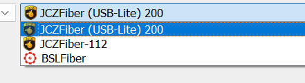

Correct, I understand what you’re doing. You don’t have to physically disconnect the laser cable, just disconnect it from the laser window in lightburn. As I’m writing this I’m realizing that there is not a disconnect option, you need to switch the connection. The simplest way I can think of is to create a dummy device and switch to that.
In the laser window click devices, then add manually, choose the “no machine” profile and give that profile the same parameters as your working machine (bed size and origin location). Then when you want to disconnect from your working window, select the no machine profile. That will disconnect from your laser and you can go to a different window and connect your laser there. If this is a frequent workflow, I would go so far as to make the no machine profile the default, that way there is no confusion as to which window is connected.

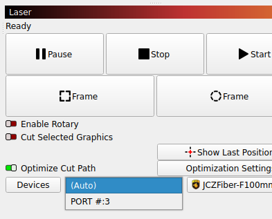

I don’t think my jcz will let me disconnect it via the Lightburn panel without creating another device. There are only two options, both result in the jcz board connecting. I suspect auto is the same as the port option.
