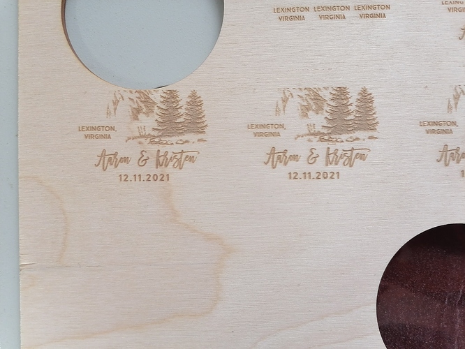

I have a strange problem ,when I engrave several individual objects,the first is with perfect quality the rest look blurry.Sometimes the first and the last look perfect other blurr.
Has anyone encountered this problem? If I engrave it one by one no problem quality is perfect. Use lightburn 0.9.18

Please show what you are seeing. Examples and the LBRN file(s) should help us understand what you see.
This is a picture when I engrave together.
This when I engrave one by one
Are all the settings identical otherwise? Are they being engraved at the same position on the laser?

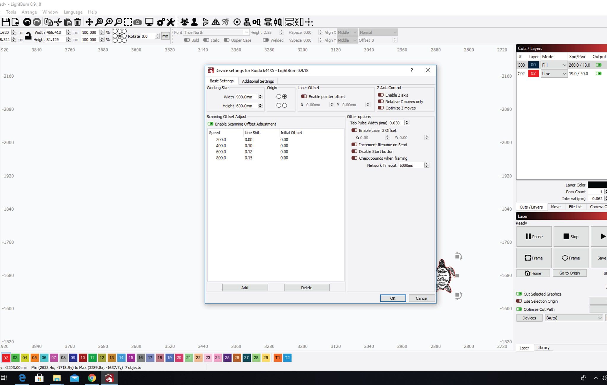

That looks like a scanning offset issue, but that should be the same regardless of how many items you do at once. If the two jobs were run at different places on the laser, it could be beam alignment.
First thanks for help. Settings are the same position too.When changing position the result is the same engraving one by one perfect several bad. Mirror and lens alighment.This is my scanning ofset settings.
