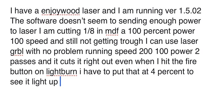

Enjoywood desktop laser not getting the power
You most likely added the laser as grbl-m3 type, which sets the s-value to 255. I guess your laser uses an s-value of 1000. Check your device settings.
