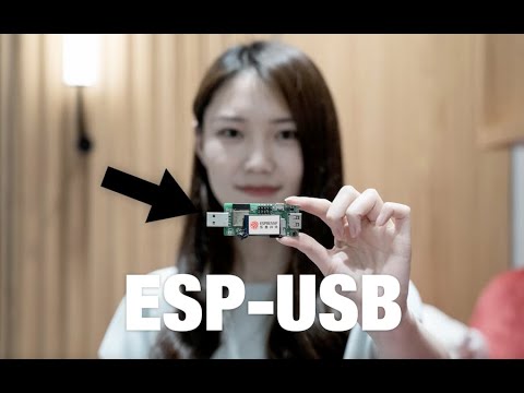

I would hunt around on the Internet for software that uses something like the ESP32 to just make an IP → usb type connections. Seems I’ve seen similar diy connections. Some are also bluetooth…
This is a Chinese plug for one of their boards… multiple operations, but similar.
