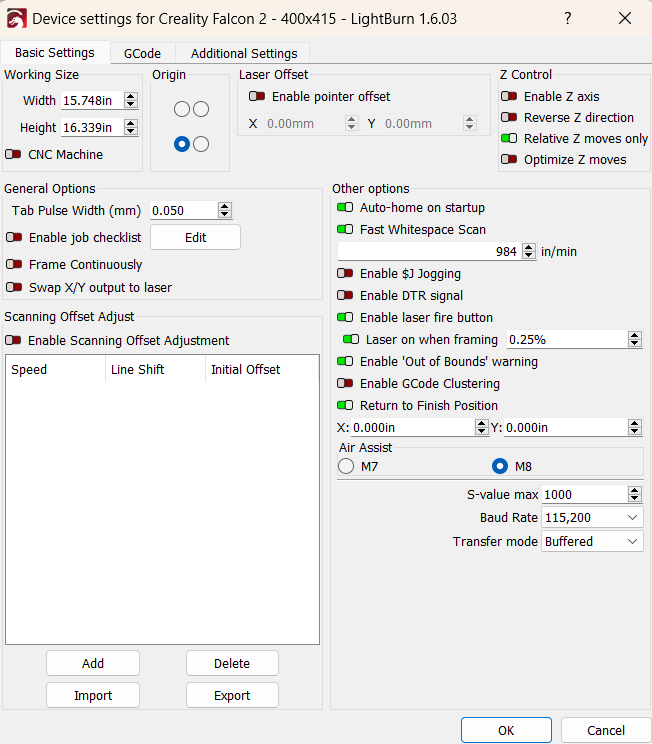

The Current Position is only .001, .001 from Absolute Coords of 0,0, so that’s why I didn’t bother taking any other screenshots of laser head positioning because the L/L corner was constant for all tests. I hope this helps. Let me know if you need anything else. I think I’m going to run a sample test of my project now to see how it does with positioning and without errors! Have a great day!

Thank you for that info. I don’t see a problem with your sizing like I somewhat expected to see. The only thing I can think of is that you weren’t dead center on your X axis when you set your lower center origin. Since your graphic is 387mm wide on a 400mm bed it doesn’t have to be off by much to cause a problem.
Type in the move box X 200 and whatever Y value you need to clear your feet. Click Go and set the origin. Test it on cardboard.

I was able to get the entire output of the project per my original methodology, (not the mermaid method). I used a low number for lines per inch and low power, since I was only trying to prove out my method. And it worked as expected. Leaving all the graphics visible, even out of boundary items, was key for not causing errors.
Having my new spoilboard was very helpful. The lowest line (X-Axis) is only about 1/2" behind the feet of the machine. I have 3 positions for each leg and so I spread them out to the widest position.
Due to this helpful spoilboard, I decided to use Absolute Coords and then repositioned the board 3" each direction per those out of bound item when I was ready to engrave them.
But here’s what I’m having trouble with. Current Position, or User Origin. Let’s say I move the laser head by remote, then use Get Position, and then Set Origin. Then after I do this, then I perform a Frame and it would always crash! I know for a fact, that the image had enough room to be lasered in the given area because I proved it with by using Absolute Coords and running the program in 3 steps successfully. I just don’t understand why I can’t get (CP or UO) to work in the Start From?! This is driving me crazy! I’m guessing this might be due to those out of bound items that are still visible?

When using User or Current, turn on “Cut Selected Graphics” and only select what you want to burn. Play with the “Use Selection Origin” as well. You will see that the green origin point can move around depending on what is selected. When in Absolute, it automatically ignores anything out side the work area, but in the other modes it looks at anything on the screen, even if it’s outside the work area.
User Origin with the Left Butterfly selected and use selection origin off.
And then with Use selection origin on but same lower center point chosen.
Notice the different location of the green origin indicator in each screenshot.

This is making better sense now! Don’t ask me why I’ve ignored reading up on these features. Probably because the term “cut” was implied and I’m only doing engraving. :joy: I haven’t got to do any actual cutting with my new laser yet because I still need to get proper safety equipment. I’ve barely used this engraver since buying it new 6 months ago. But this winter, I will be doing a custom enclosure with honeycomb, outside venting, camera, and possibly a scissor lift to engrave thick items. I’m going to test this out later this morning and hopefully I will get a better grasp on the proper usage.

There’s also an interaction with the Ignore out-of-bounds shapes if possible setting:
Generally you want it turned on, but one side effect is ignoring shapes that are out by an itsy, leading to questions about “Why isn’t LightBurn engraving my shape?” :grin:
